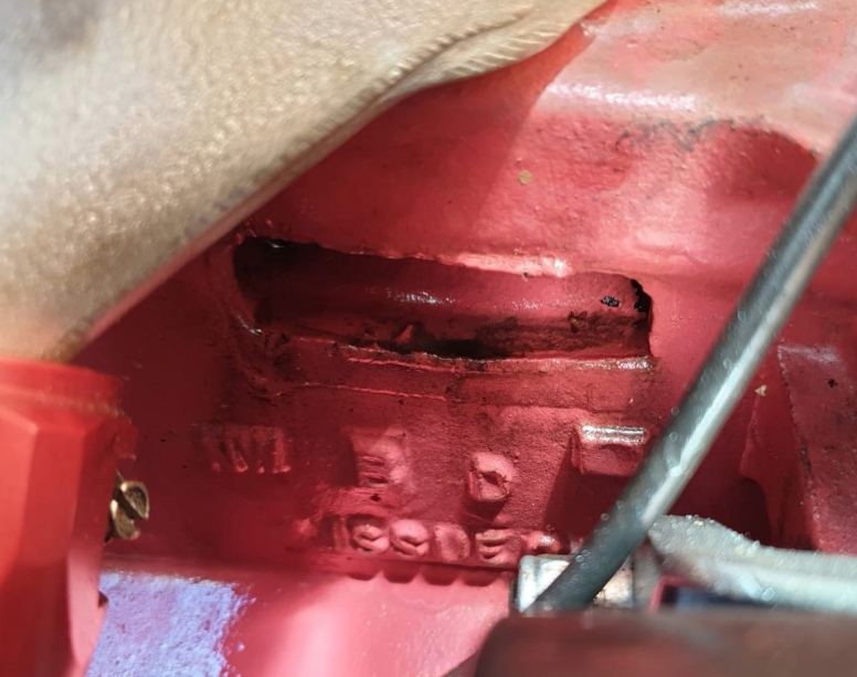

Any ideas where the oil would be coming from if it gathers where pictured? It's just below the carbs on the side of the block, it's a dolomite sprint engine....

Water pump seal fersure! Bad luck dude!

Is that an awkward job?

It means taking the water pump out, so yeah, pretty unpleasant, do able at home, but no fun! There is an instruction thread on here somewhere.

Should we be able to see in that gap? Like this?

Yes.
