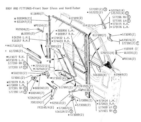

I'm guessing the rivet is 557222 which is the top hinge pivot, though there is also a blind rivet hidden away on the frame.

#21 Post by RSi »
LOL, blimey that diagram has just scared me ..... :)

#22 Post by Carledo »
I rather fancy the rivet assembly is the 3 part combo comprising HUO504, WLO205 and WPO156, shown centre right of the diagram, though I can find no description of these parts in the text.
The drawing is needlessly complex and not very accurate, the 1/4 light assembly is much simpler when you have it in your hand!
