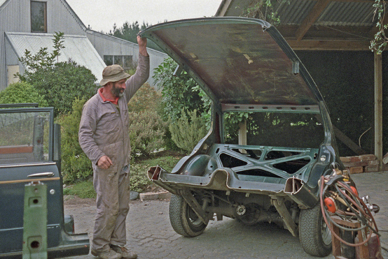

Tony, I was faced with the same problem when I restored my car a few years ago.
My suggestion is that you find a good donor rear end with a good solid roof and do what is termed a cut and shut. Cut the A and B pillars at the join line which is visible from the outside if you melt the lead off, or visible from the inside when you remove the trim. Cut the donor rear at the front of the join in the chassis floor, cut the rear off your car at the rear of the join in the chassis floor, unpick the strip off where the floor is to be joined and wheel the two halves together. Rehang the doors in order to get all the shuts correct, tack weld, sit the windscreen in place and if it all fits remove the screen and doors and weld up.
Somebody like James would have the job done in a matter of minutes and then if you mount the body in his rotating jig you would sort the sills out in no time at all. Take note of the comments he makes concerning working on the roof and how it will "move" when you attempt to repair it. I recommend leaving it well alone.
The chassis plate and body identifier on your early car remains untouched.
I have three spare donor bodies here if you get stuck. I have shown a photo of one of the spares elsewhere where Alun and Steve pondered the option of shipping it back to the UK. Perhaps I could send back all three - all from a non-smoking, pet and covid free country/home!!

Hi Robert,
Thanks for you email, I remember reading your thread about this.
I think this is a step too far for me, it really would need to be aligned on a jig, plus replacing half the shell sort of reduces the historical value of this car being one of the 1st 2000 made.
I am going to pursue replacing just the roof & gutters if needed.
