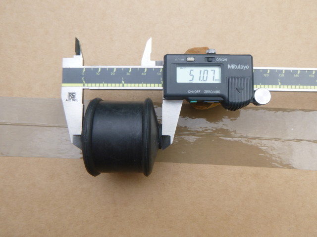

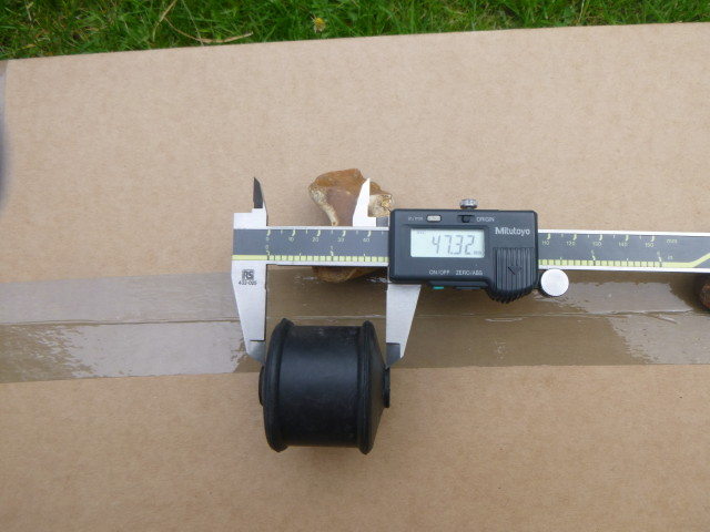

I have a couple of original ( rubber) trailing arm bushes . They are so original that they have the old part number of ULC1580.
The dimension over the sleeve is 51.07 mm and the max; dimension of the rubber just below the sleeve is 47.32 mm.
HTH,
ULC1580 sleeve.jpg (64.93 KiB) Viewed 789 times
ULC1580 max rubber.jpg (68.38 KiB) Viewed 789 times

Thanks guys. Looks like my superpro close in length to NOS above thanks Tony. Curious on the superflex if it’s handy Steve, if not don’t waste any time hunting. Been out and looked at the hangers and don’t appear concave at all, sides are straight although they do splay out at front and get narrower at rear, which kind of makes sense. Going to check out another local sprint tomorrow and take some photos to compare and if all similar, then I’ll fit it all back and hope back end tightens up when done. Cheers again for input all.

Found and measured my Superflex bushes they come out at 50.5 mm across the metal sleeve, near as my old fashioned steel tape could measure them.

Thanks Steve. That’s pretty much same as tubes of superpro. Going to go ahead and bolt it all up and before putting fluid in brakes see how much side to side movement I end up with. If too loose then I’ll grind tubes a mm and hope the brackets/ hangers can pull in a bit and clamp tight.
