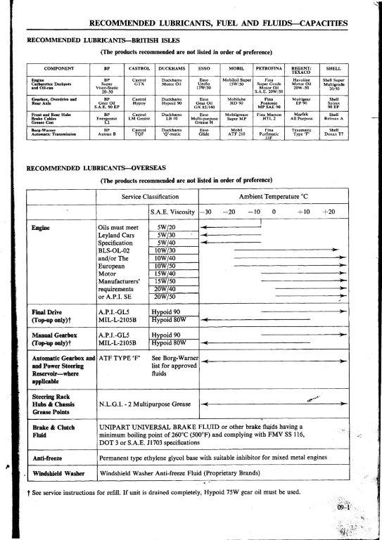

Looking at my 1977 1850 Manual, it says 20-50 for uk
But if you look at the overseas recommendations, it gives the temperature range and the recommended oils for this.
For example 10-40 would be good for -20 to anything over +20
20-50 on the other hand is from 0 to anything above +20
In previous manuals it’s not set out as clear as this.
- Dolomite Oils20210121_15303612.jpg (88.78 KiB) Viewed 962 times

The synthetics hadn't really been introduced back in 1977 so weren't an option.Manta wrote: ↑Thu Jan 21, 2021 3:48 pm Looking at my 1977 1850 Manual, it says 20-50 for uk

Fair point, I was more referring to the question on viscosity,dursley92 wrote: ↑Thu Jan 21, 2021 4:27 pmThe synthetics hadn't really been introduced back in 1977 so weren't an option.Manta wrote: ↑Thu Jan 21, 2021 3:48 pm Looking at my 1977 1850 Manual, it says 20-50 for uk
