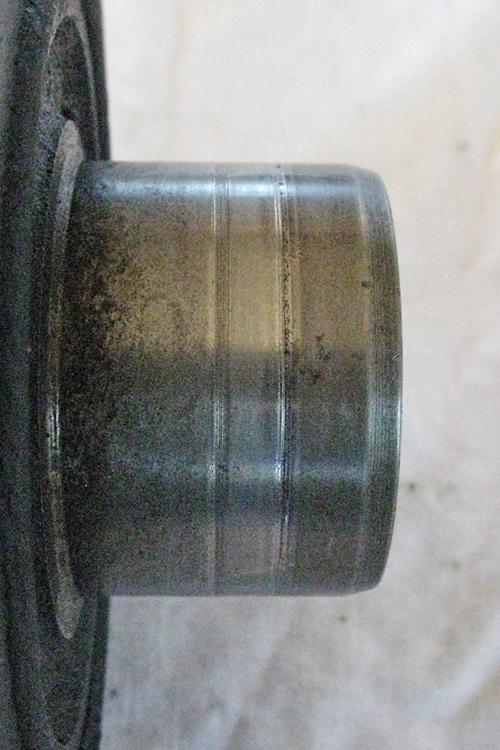

Can anyone explain what the two machined grooves are designed to do on the crankshaft pulley of the 1850 Dolomite and the Dolomite Sprint engine. Each pulley is different but the grooves sit about where the front crankshaft seal runs on the two different engines.
On the Sprint engine which I am currently working on, the crankshaft seal needs replacing. I have removed the pulley and if you look very closely at the photo of this pulley you will see that there is a polish mark just outside the right hand groove which is about where the lip of the seal was running but as the lip wore I suspect it moved into the groove.
The polished centre between those two grooves was probably where the bulk of the outer seal face rubbed.
I shall fit a double lipped seal and position it slightly proud of the timing cover so that both lips of the seal run in that polished area.
That is unless somebody tells me that my thinking is all wrong and that those two grooves have a particular function.

Both of the grooves are due to wear. The whole of the surface should be smooth, that is polished.
You need to polish up the surface and reposition the seal or preferably find a better replacement.

If finding a new pulley is difficult, look at a Speedi-Sleeve to repair it with.

Option
1) Find a other pulley that’s hadn’t got wear marks.
2) Sprint Speed do a modified Pulley boss that takes a BMW dampened pulley.
3) weld up grooves and machined back smooth.
4) Machined down to remove grooves and fit a sleeve over the top.
5) Don’t fit the seal all the way home leaving it proud.
So the seal sits elsewhere on the pulley.
Personally I’ll go for either 1-3 or 4.

Thanks for the comments, folk.
I shall fit a speedi sleeve and new seal for that will be the easiest and quickest option.
