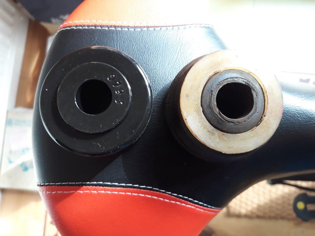

Could I enquire with the wider community please as to why when using poly bushes, the nylon washer in not required?
I ask out of curiosity.......the poly bushes I have bought from Chris Witor appear to have an edge to them where the washer would sit. Please see pic of my new bush and old bush with plastic washer. And t made me curious to understand the reasoning before I put the tie bar back into the car this weekend...
Thanks...

Looking at the photograph on the right it looks as if it bush has a metal bush in its middle, if this is the case it is definitely not the correct item, also the centre hole in the flat nylon washer should only be just big enough for the radius rod to pass through it so again it is not the correct item. It might be a damaged nylon bush which has been reused as when I have stripped a number of 1500 rear axles I have often found that the rubber bush has punched a hole the size of the rear axle mounting hole in the nylon washer.
I have stripped a number of rear axles which have had polyurethane bushes fitted and I have noticed that they have started to take up the shape of rear axle mounting hole, so my assumption is that the new Superflax polyurethane has been produced with this shape either on purpose or by just copying a used bush. Can you please measure the diameter of the raised section on the new bush and see if it is the same size as the hole through which the radius rod goes which is 1.25 inches. The mounting plate is about ¼ inch thick so the raised section could be up to 1/8 inch.
