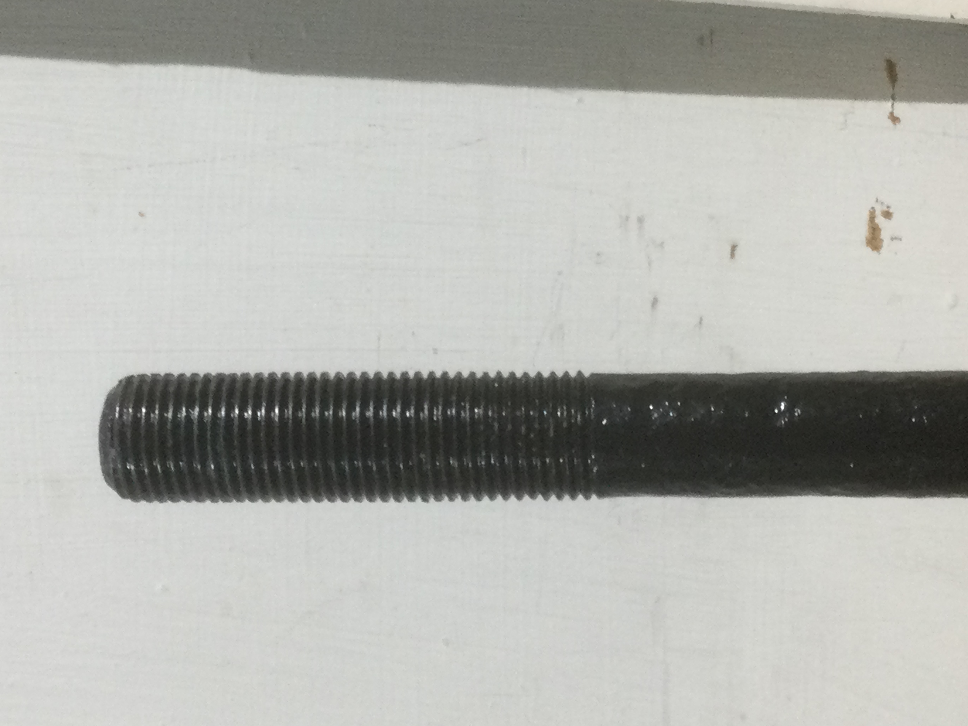

No, it is not possible...
The fwd track rods have a rolled thread.
Alas said threaded portion is insufficiently long to allow for track rod shortening for Dolomite use.
Ian
Ian

T'would be a waste really, to cut down the rare long track rods to fit a RWD Dolomite, when stock track rods are plentiful, it's the rack bar itself that is causing the current rack shortage, our current reconditioner is a lot more picky than his predecessor!
