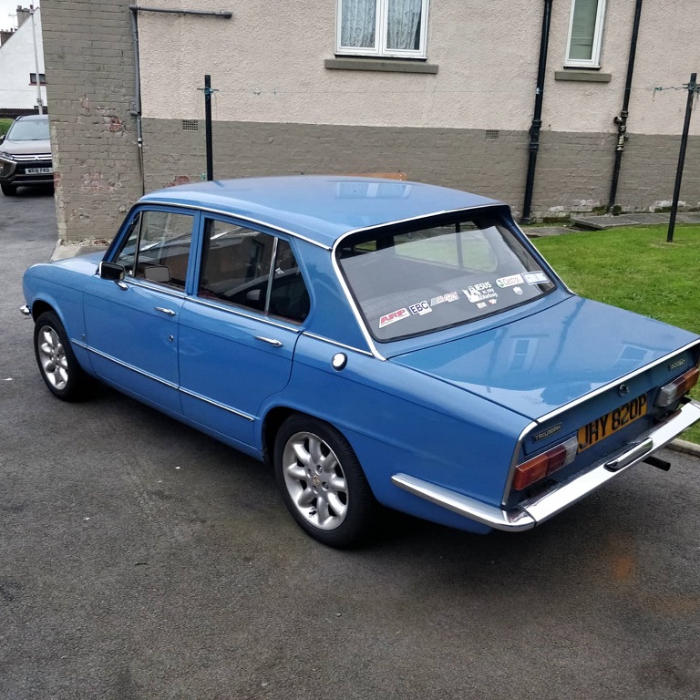

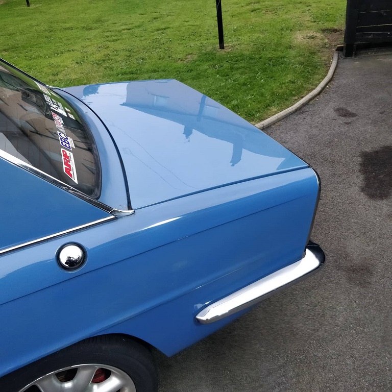

With some delightfully overcast but warm days here in Aberdeen, I decided to brake out the DA polisher and see if I can do something with the brushed on looking, runny and fence paint splattered paint so the new boot lid sticks out less (Only the last issue is my fault).
As per the pictures of the cars good side, I think it turned out a lot better than I could have hoped, especially if you stand 2 meters away. After washing the car I used Maguire's ultimate compound (Good but my, car care products are expensive!) with a aggressive pad then buff off with a microfiber cloth its was a good improvement. Next with a soft pad I used some Poor boys show glaze (never heard of it before but I won it in a raffle so worth a go). I went over the paint again, although I don't think it was a big improvement it seemed worth it, although I think skipping it wont make much difference.
Finally with Maguires GoldClass carauba plus wax to protect ait and being socially distanced the paint was a lot better, but I was realistic with the state of the paint and after polishing the chrome with Autoglum metal polish I was very happy with the good side, and even the bad side with its rusty rear arch and hole in the front fender!
Note to self – I think clay baring the paint first would have been a good idea……

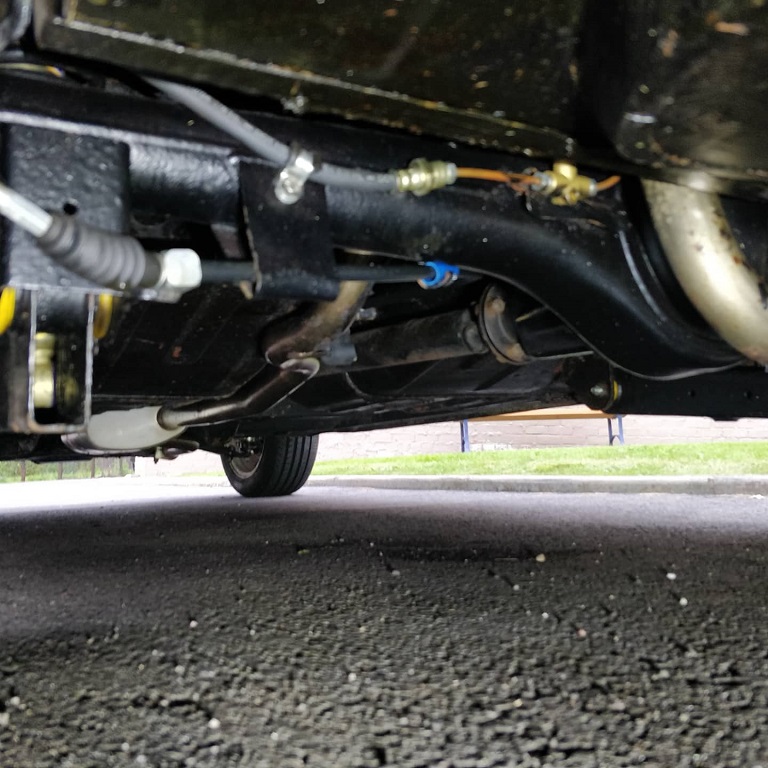

Next on to the underside, as after the rear rebuild and disc conversion I wanted to protect the newly painted parts, the underside and the bits I just chucked hammarite direct to rust on without the best amount of prep!
I have been reading about Lanoguard for ages so bit the bullet and spent best part of £150 on their products ( I plan to do my other 2 none classics and my E46 and motorbike as well, sop bought a lot).
With the hose extension on the 2 littler bottle it was no problem at all and the spray nozzle did well from a fine mist to a jet, the only issue is it deffo has a sheepy smell, although it only lasted a few hours. It went on well, first it was quite glosses but after a day it died down and looks good, and on rush it has taken a lot of the redness out of it so it looks better on the floor pan. I only used about 1/3 of the bottle so plenty left to top up next year and probably do my Vauxhall Adam as well.

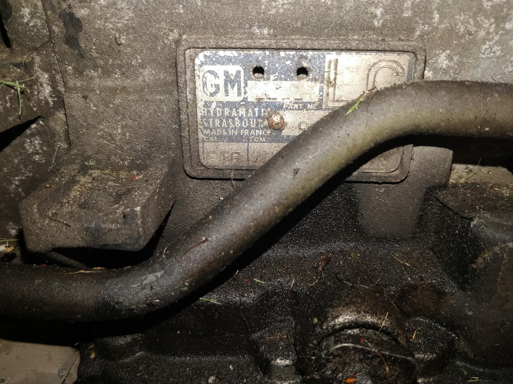

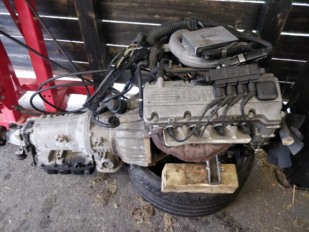

Definitely a 4L30, the twin trans sumps ar unmistakable. The model code is different to mine (surprise!) but it shares the legend GM Hydramatic, Strasbourg, France. Did you get the trans ECU with it? Or is that the engine ECU on top? And do you have the shift lever and if so, does it have sport and snow modes available? The wiring for the shifter is complex all on it's own with around 20 wires into it! I notice it says E36 on the photo, what year would that be? Though the 4L30 has been going since 1969, it has gone through several facelifts, mine also has cooler pipes running down the O/S that are not visible in your pic. However the smaller (than an Omega) Beamer may not have needed a cooler. Not sure my Sprint NEEDS one with only half the weight to haul around, but I had the facility so why not? Incidentally, I used the Saab 9-3 rad as on the Carledo but got a new auto one with trans oil cooler incorporated. Was on special offer at the time from Euro car parts, £58!
Mine has a loom for the trans attached to the engine assy that meets the body loom in a large round blue plug (46 tags IIRC) All the trans wiring runs through this one. I have 3 other plugs but they all carry engine stuff. If you have that blue plug or similar should be easy enough to generate a diagram thats legible without a computer to zoom in and out! Or at least a pin-out chart with colour codes and destinations. Which is how I worked mine.
