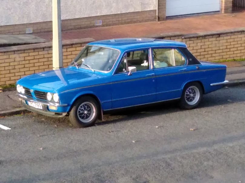

This is how my car sits on the same GAZ set up. It’s part polybushed and runs 185 65 tyres. As already said it’s a case of trial and error. I was lower than this but it was too harsh so I raised it an inch. I’m just about to raise it another 20mm or so because the subframe still catches the camber on rural lanes! Speed bumps are a pain too. I have the screw adjusters around halfway on front and rear. Both need to be a lot softer and you deffinately want the rear softer than the front.

I love the way it looks but want a bit more comfort. Must be getting old

Great info on this thread, the lowered stances look excellent. Only rough roads stopped me from doing that to mine (for now), otherwise a slight drop suits these cars (visually) really well..
Re: Gaz Shocks set up
This is exactly how i want mine to sit when its back on the road.Bish wrote: ↑Sat Sep 11, 2021 9:27 pm This is how my car sits on the same GAZ set up. It’s part polybushed and runs 185 65 tyres. As already said it’s a case of trial and error. I was lower than this but it was too harsh so I raised it an inch. I’m just about to raise it another 20mm or so because the subframe still catches the camber on rural lanes! Speed bumps are a pain too. I have the screw adjusters around halfway on front and rear. Both need to be a lot softer and you deffinately want the rear softer than the front.

I love the way it looks but want a bit more comfort. Must be getting old![]()
Was this on the round britain run last weekend?

Not old, sensible. If I was on a race track, drop it as low as possible but on our pathetic moonscape roads? Nah, I much prefer a comfortable car, which are increasing hard to find these days. Reviewers only care about how sporty a car is and want everything fitted with giant wheels and rubber band tires, which further ruin the ride.Bish wrote: ↑Sat Sep 11, 2021 9:27 pm This is how my car sits on the same GAZ set up. It’s part polybushed and runs 185 65 tyres. As already said it’s a case of trial and error. I was lower than this but it was too harsh so I raised it an inch. I’m just about to raise it another 20mm or so because the subframe still catches the camber on rural lanes! Speed bumps are a pain too. I have the screw adjusters around halfway on front and rear. Both need to be a lot softer and you deffinately want the rear softer than the front.

No I wasn't on the RBRR last week - mores the pity - I would love to do it one year. To be honest I wouldn't want to take my car on the RBRR at the moment. I`m finding the car sits a bit too low. Yes it looks good but bracing for potholes, and manhole covers etc is getting a bit boring. I wouldn't of wanted that for a solid 48 hours of driving around Britain.
I`m in process of raising the suspension another inch. I reckon it will drive a hell of a lot better, and I also think it will still look right too.

Well with age comes wisdom!? I hope......cleverusername wrote: ↑Fri Oct 08, 2021 4:30 pmNot old, sensible. If I was on a race track, drop it as low as possible but on our pathetic moonscape roads? Nah, I much prefer a comfortable car, which are increasing hard to find these days. Reviewers only care about how sporty a car is and want everything fitted with giant wheels and rubber band tires, which further ruin the ride.Bish wrote: ↑Sat Sep 11, 2021 9:27 pm This is how my car sits on the same GAZ set up. It’s part polybushed and runs 185 65 tyres. As already said it’s a case of trial and error. I was lower than this but it was too harsh so I raised it an inch. I’m just about to raise it another 20mm or so because the subframe still catches the camber on rural lanes! Speed bumps are a pain too. I have the screw adjusters around halfway on front and rear. Both need to be a lot softer and you deffinately want the rear softer than the front.

The car does look good in that photo though, even if I do say so myself
