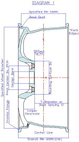

This diagram might help clear up some of your confusion.
I use RFX revolutions on my 1300fwd abet with a few modifications
they are 5.5x13 with a ET of 28mm
