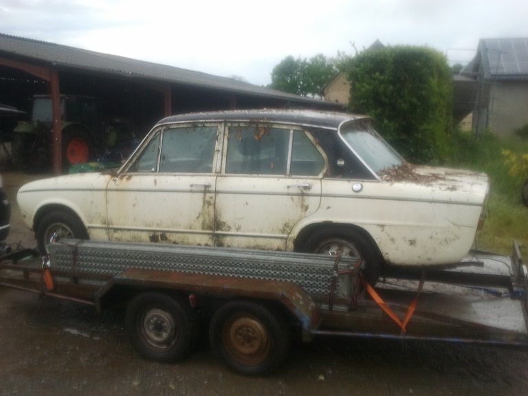

#21 Post by spitrouette »
Hello
I am in France and I rebuild a dolomite sprint of 1976 the paint code displayed in the car is C11 which corresponds to black however my car is white what can be the modern paint code today
Good day
Five years already on the day of recovery

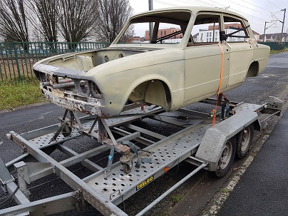

#22 Post by spitrouette »
Today

#23 Post by Carledo »
If it's a 76 car the correct white is code 19, simply called "White"
C11 is a trim code the C denoting cloth trim and 11 the colour black.
HTH, Steve
