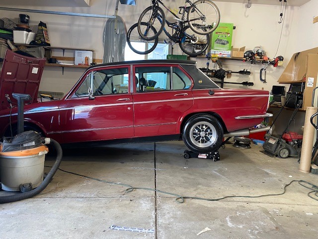

I am trying to locate a coolant leak. I loaned a pressure testing pump/gauge from autozone (US) and pressurized the expansion tank to 13psi. It appeared that I had a leak at multiple points on the inlet side of the cylinder head. There where also leaks from the thermostat housing tube connections. To test if the thermostat leaks were running along the cylinder head joint I jacked up the car so that the cylinder head was sloping forward. I was surprised how much I had to jack up the car and this is with the help of the slop on the garage floor.

At this angle there was no evidence of any leak along the cylinder head joint so it does look like the water was running along the joint and pooling on top of the block. However there is a definite pool between the cylinder head and the water pump. Its very difficult to see in that area. This could be the cylinder head or hopefully the water pump gasket.
I plan to remove the inlet manifold to gain access and get a better look. Once I have the manifold off is there anyway to test the cylinder head joint.

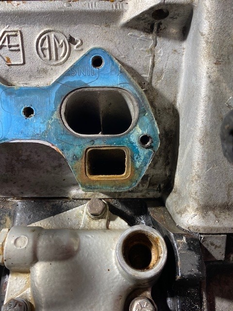

Re: Coolant Leak
This looks like it could be the source of the leak.
Any advice on the best gasket to use and where to get it.
The manifold appears to be flat when inspecting with a straight edge. Hopefully I can get it to seal without skimming it. Plan B.
- manifold.jpg (113.78 KiB) Viewed 1005 times
Re: Coolant Leak
NOS on ebay, a payen nos set or make one yourself from decent gasket paper.
The current grey newspaperpaper ones that every classic sellers do sell are useless.
- Posts: 1560
Re: Coolant Leak
Exactly were mine leaked and I tried a variety of different gaskets and sealants with no success. I hope I am wrong but the only thing that cured it was getting the manifold skimmed.
