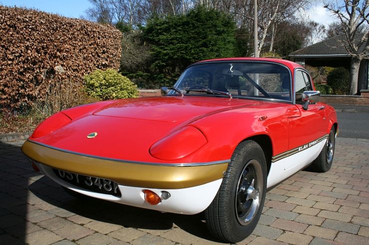

I painted my Elan in International Yacht Paint (ideal for fibreglass) with a brush, then flatted it and polished it by hand. Looked fabulous. Then I sold it - the only car I made a profit on.

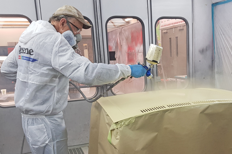

Re: Could I paint my roof with aerosols and get a good finish?
I used a Glasurit 2 pack paint when painting my last car. An excellent paint choice. The agents were able to give a perfect colour match.
The standard practice in this country is to spray within a well ventilated dust free booth and to use either an airfed respirator or one of the very excellent 3M face masks.
I found the 3M mask a much better choice. It filtered out all the fumes very satisfactorily and was not as cumbersome as having a second air hose trailing behind me. Most of those with whom I shared the facility chose the 3M option.
Robert
Robert
