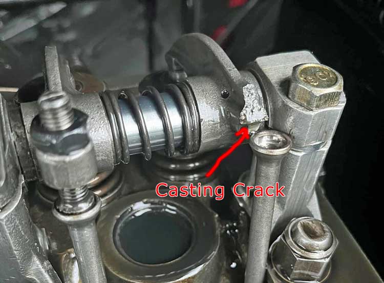

Can't answer that one but be aware, a friend with a local garage who repairs Classics had 2 'new' rocker arms break on an engine (not a Dolly but aftermarket makers are limited) he had overhauled whilst on a test drive. When I looked at them on the underside you could just see the small crack (from the poor casting process) that had led to the complete failure so before fitting any 'new' ones make sure you thoroughly inspect them
