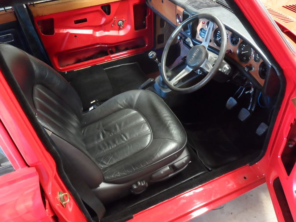

I fitted a set from Coverdale to MSO about 10 years ago, they seemed to be the best around at the time. They have lasted well not that the car gets used that much.
The centre carpet under the front seats is supplied in 3 sections unlike the original 1 piece, I seem to remember the bit that goes over the transmission tunnel is a bit baggy, but once the seats are in you don't see much of it anyway.
This is the only photo I have from the time.
