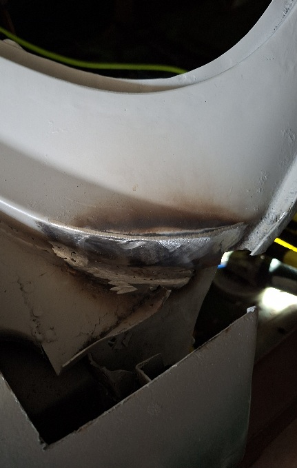

Today I went to the car and looked at the rear quarter panel and I wasn't happy with how the repair looked. So I cut along the original weld and repaired it so the panel now looks like the proper shape and won't take much to finish off before final paint.

Today I got the C post repaired. It warped a little after doing all the patches so had to cut a cross in it to remove the dent.

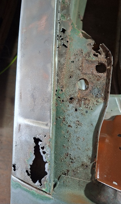

Today I re welded the wing repair to make it flatter and easier to hide when finishing bodywork off. Cleaned and painted the lower part of the B post. Started to sort out the bottom of the A pillar by cutting out all the rust and priming ready for re building. Spayed some top coat to seal the primer and repairs I've already done.

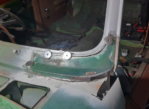

Got the A posts finished off. Cleaned up part of the engine bay, rust treated and painted. Cleaned up front panel and found a few more holes. Treated rust and primed ready for repair. Started to clean up inside front wheel arch.
