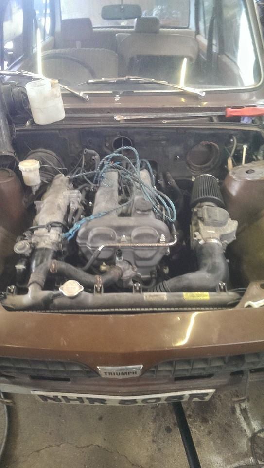

I will upload more tomorrow as I'm spending the day in the workshop. Under the bonnet is about 90% there now so you can see how much room is left or the lack of it!

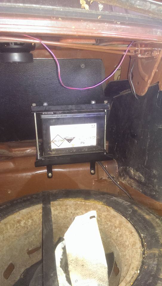

- battery fitted in car
- 11903752_963677297004945_4399093695673663136_n.jpg (64.33 KiB) Viewed 440218 times

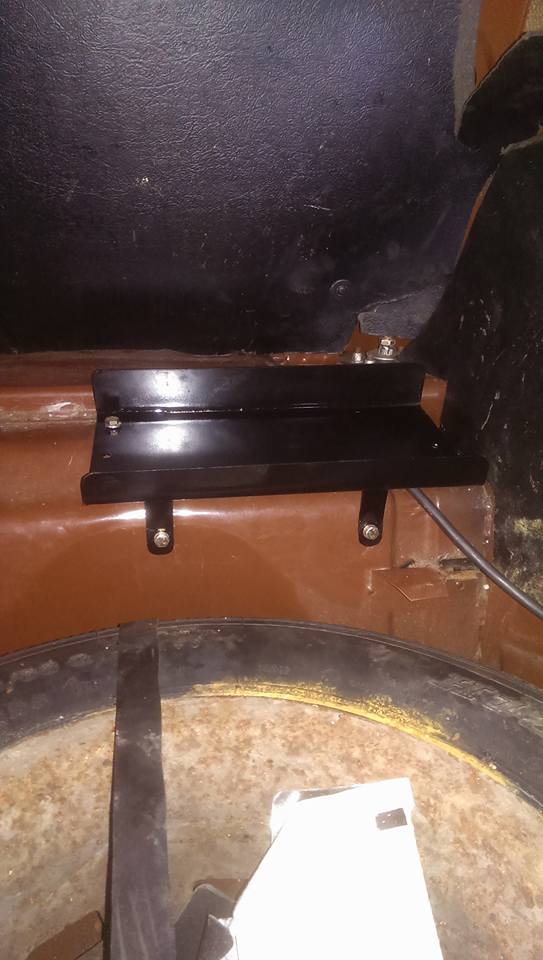

- fabricated battery box and fitted
- 11947566_963677273671614_515253698169150900_n.jpg (56.73 KiB) Viewed 440218 times

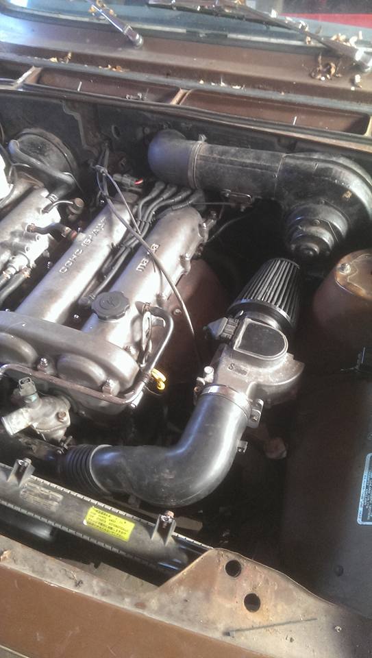

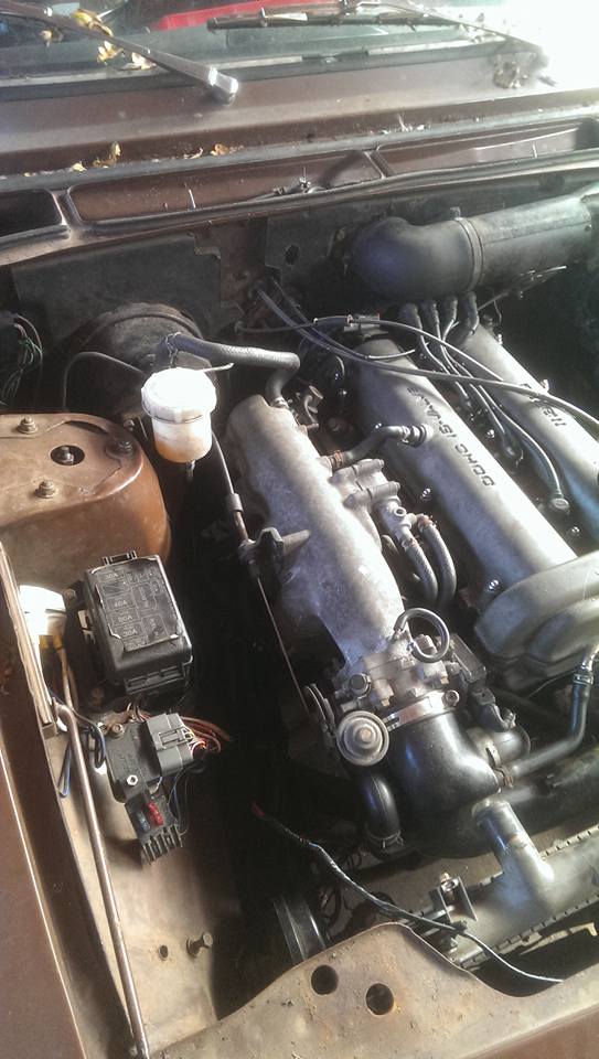

- air intake side of engine
- 11892066_963676930338315_3384120771980631970_n.jpg (66.84 KiB) Viewed 440218 times

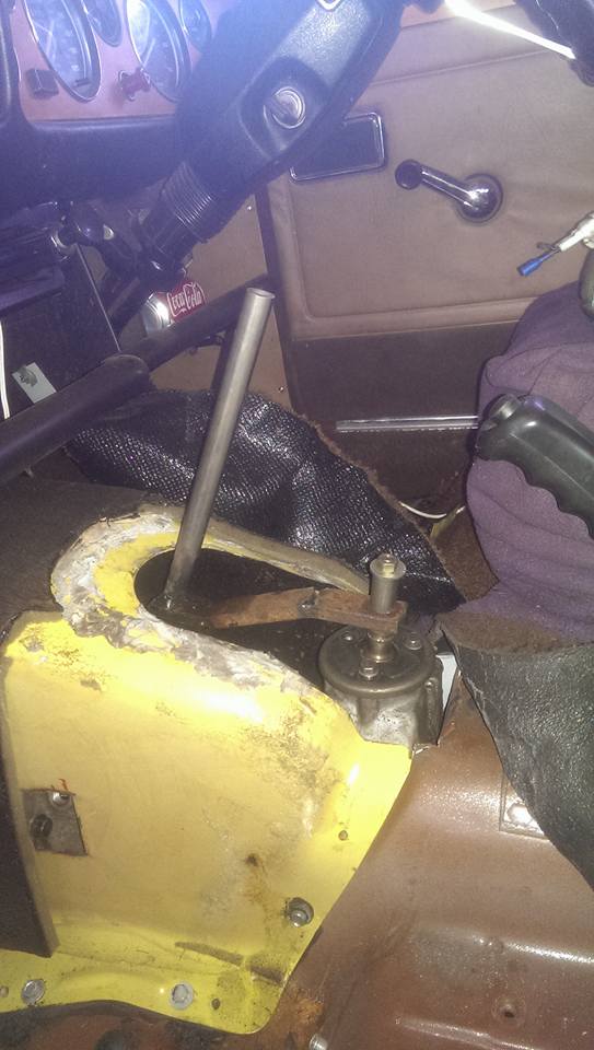

- attempt 2 and its nearly in the same place as old one. need to make a better looking one now i know it works
- 11892075_963677423671599_183348621229955815_n.jpg (62.32 KiB) Viewed 440218 times

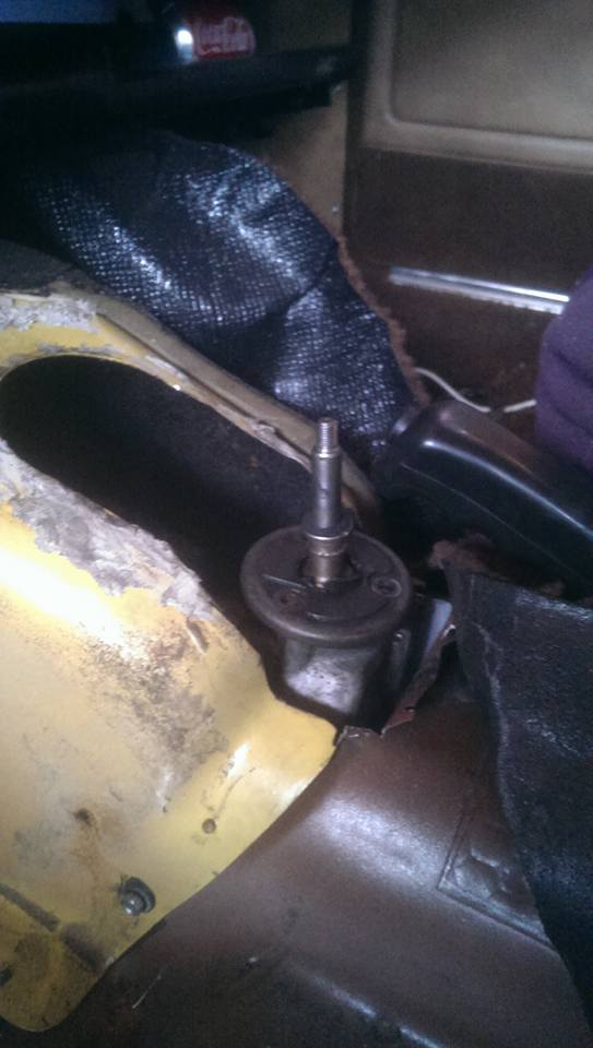

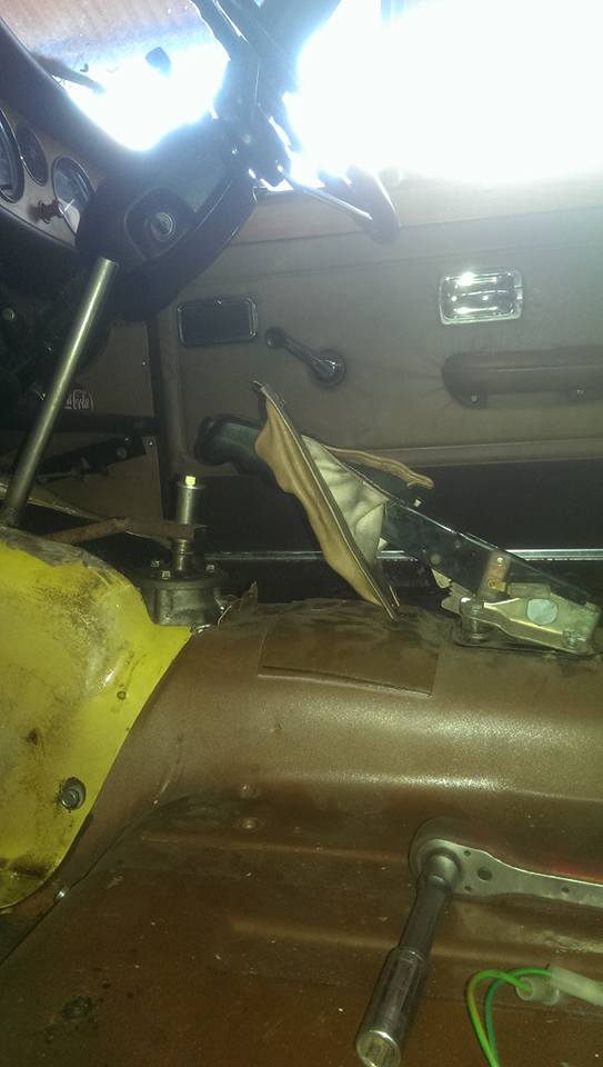

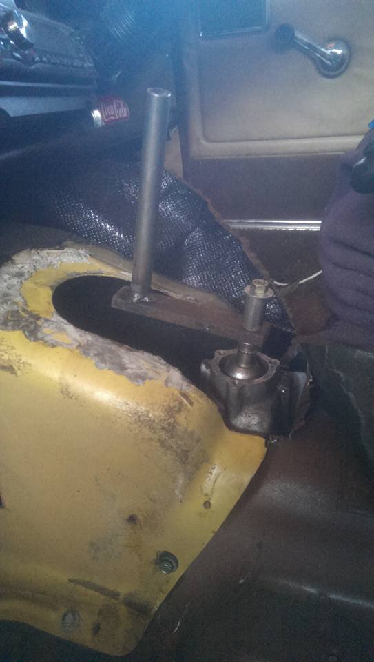

- first attempt works but stick position isnt right
- 11873791_963677397004935_4288927548112020404_n.jpg (45.1 KiB) Viewed 440218 times
- gearstick stub fitted to take measurements
- 11222192_963677377004937_1711190152136393728_n.jpg (49.39 KiB) Viewed 440218 times
- gearstick position needs moving foward more
- 10308218_963677317004943_5735362964435097598_n.jpg (70.89 KiB) Viewed 440218 times

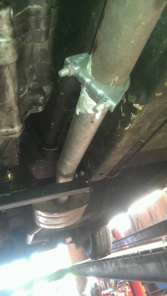

- dolomite exhaust modified to meet mazda down pipe
- 11896069_963677153671626_4892322049169363305_n.jpg (51.96 KiB) Viewed 440218 times

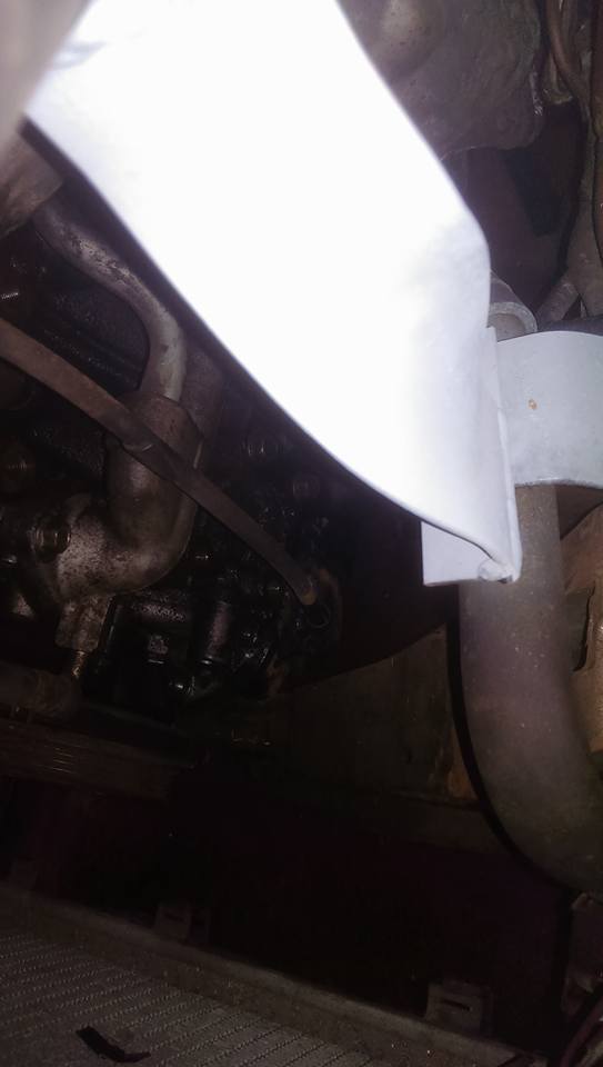

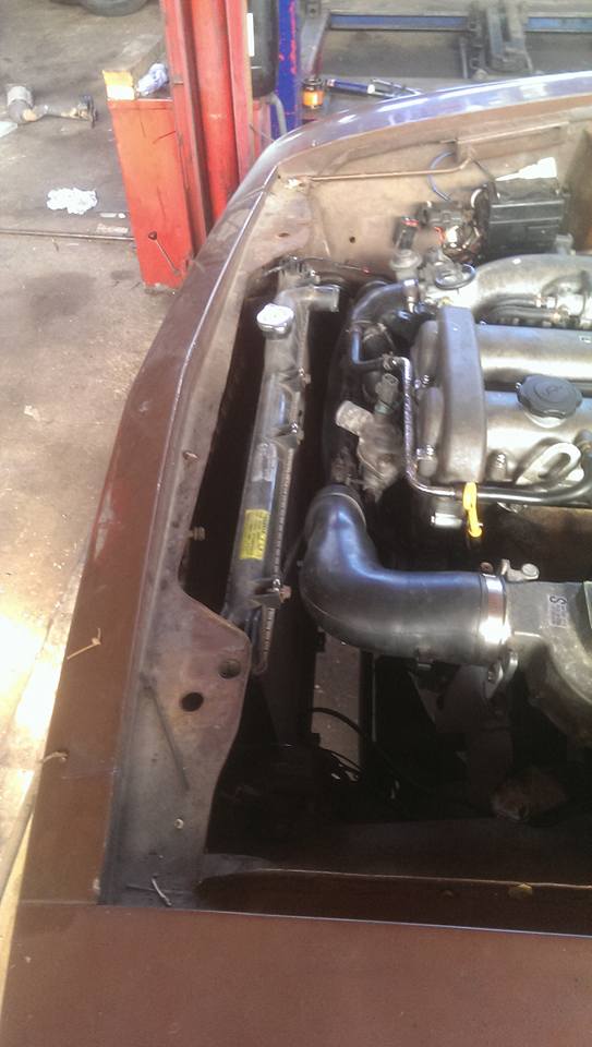

- radiator clearence

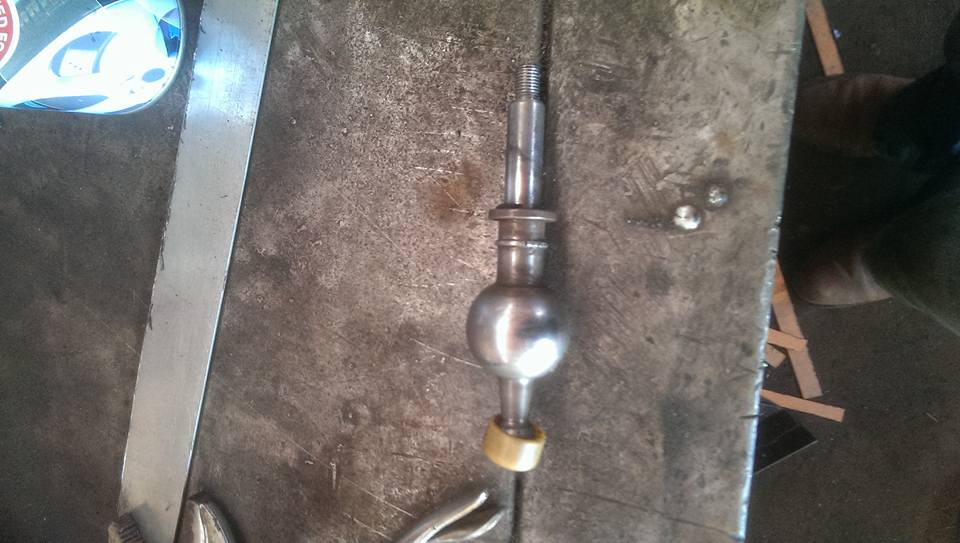

- 11902420_963676960338312_6996587291836219236_n.jpg (56.05 KiB) Viewed 440218 times
- gearstick with rubber shock absorber removed ready for modification

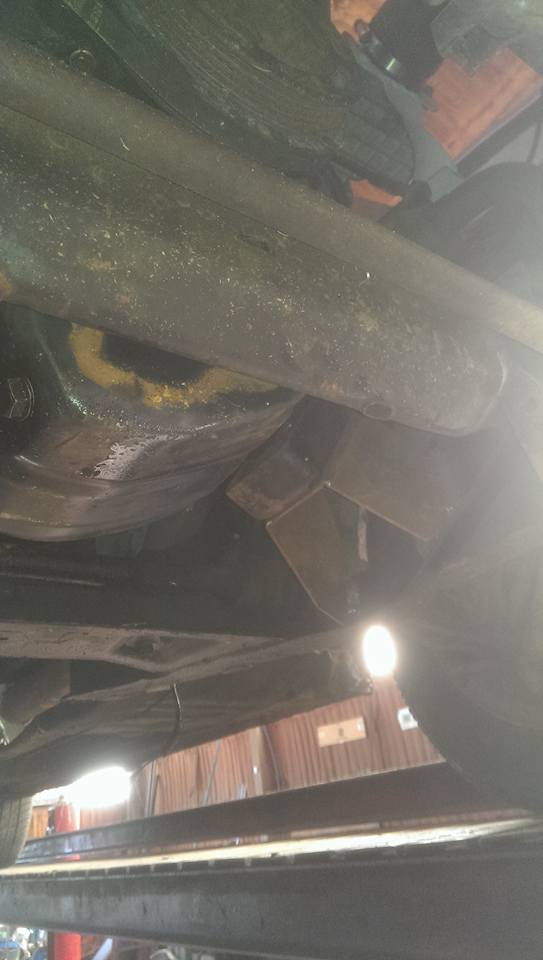

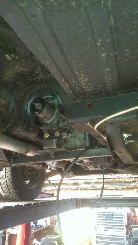

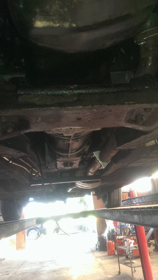

- underside of car
- 11140292_963677063671635_1157846318902063003_n.jpg (45.36 KiB) Viewed 440217 times
- fuel return going over gearbox and exhaust
- 11215160_963677127004962_8526423638372714840_n.jpg (66.96 KiB) Viewed 440217 times

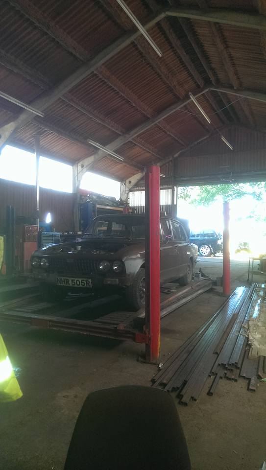

- stopped to have some food so took pic of car on ramp
- 11231856_963677253671616_1114691158017697233_n.jpg (51.26 KiB) Viewed 440217 times

Looking good keep at it, have you done the shortening mod which moves the whole selector about 6" further forward
http://the-mite.com/mite18.htm can't do the linky thing on this silly windows 10, you'll have to cut and paste it in your browser
Some good work there, I like the remote gearstick idea

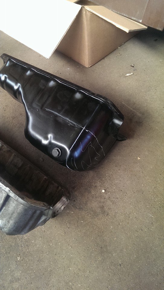

. Can you get a push fan in front of the rad- it looks tight for a pull fan?. Where did yuo get the sump from? Is that another elusive 323 turbo one? What are you doing for fuel pump- in tank or bosch style external?
I shortened the selector shaft before I even New about the link on how to do it but I did it the same way. I'm an agricultural engineer so I'm used to taking things apart. I've fitted a 12 inch push fan to the front as there's plenty of room there and just need to wire it in. It didn't take long to think up the gearstick thing it was just trial and error. The way I've done it the plastic trim should go back on once I've 're built the gearbox tunnel.
Forgot to mention I got the sump off eBay for under £60 for a new one.
i fiited the mazdain tank fuel pump i just removed the gauge sender unit and had to adjust the angle of the pump slightly. the sump is marked up and ready to cut, while the front of the sump was missing i altered the oil pick up tube. it made it easier as you can see where it sits in the sump. the sump hasnt got gearbox bolt holes on it but you can make brackets that pick up on the threaded holes on the side of the block, me and my colleague dont think yhat it will need them though as hes put a rover v8 in his tr7 and thats only got 4 bolts holding the gearbox on and they are a smaller thread size aswell.
- sump
- 10984138_893766493996026_3576509195927569526_n.jpg (112.78 KiB) Viewed 440171 times
