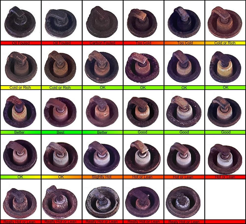

Just found this on spark plugs. When I first got my dolomite, I struggled a little with mixture. Something like this would have been really useful. Hope it helps someone out there with an equivalent lack of knowledge on classic cars!

Great posting ! Its the sort of thing that needs to be made a "sticky" perhaps.
Re: Spark plugs
That's a great find, and thanks for sharing, so useful.

Thanks very much guys! I definitely thought it was useful! Tony what do I do to get it stickied?! Do I contact someone in particular?

if the plugs have a slight pink shading or blue that could be a sign the of the head gasket on its way out. Not experienced it on any of my Dollies but did once on a Alfa Romeo
