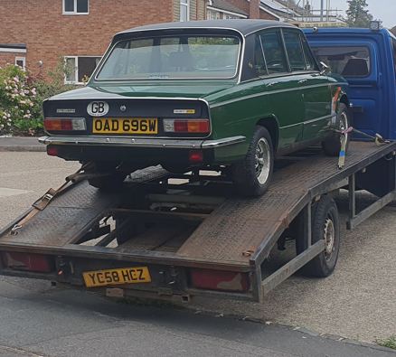

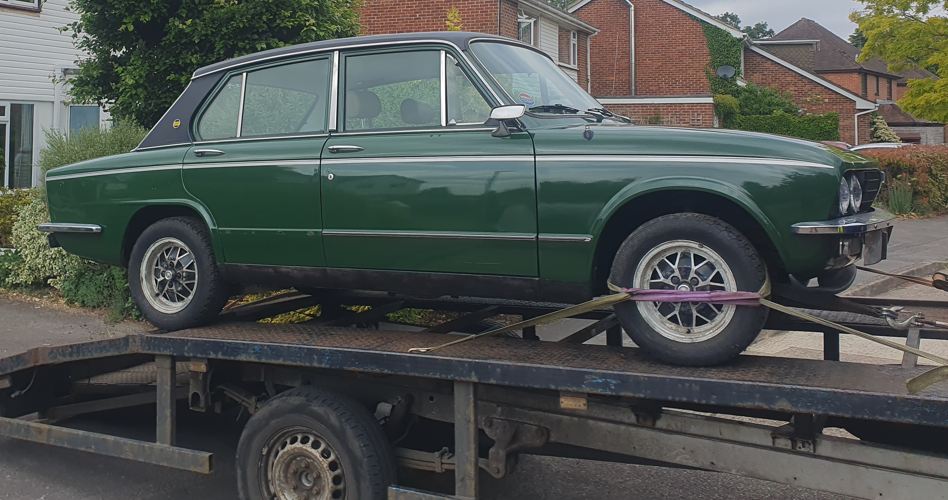

I've just joined the forum as I'm now the proud owner of a Dolomite Sprint. We think the car has been garaged for about 40 years! My father in law was the owner and it's been in his garage hidden away for all this time.

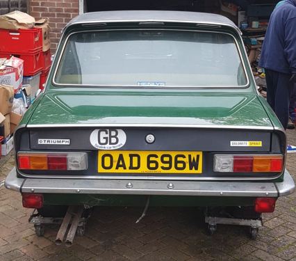

We managed to clear a path to it, and with a couple of dollys under the rear wheels, quite appropriate, we managed to get it out. After sitting in it for 5 mins I fell for her.
Now comes the task of getting her back on the road.....
She's in remarkable condition for her age. Fortunately the garage was water tight so no issues with the car interior, it's mainly the rubber components and the exhaust that need replacing.
