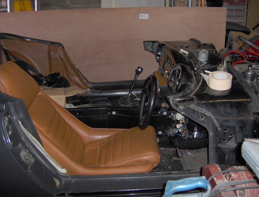

Re: Latham F2
I believe that they were sold as just a fibreglass shell that you had to get trimmed yourself.
I also have a vague memory of somebody telling me theirs had started to crack where the back meets the base. I could be mistaken on that, though.
Here's a pic of a Latham in Ireland which I believe may have the original items, after trimming.
The seats weren't available whrn I got my kit, I originally used some Cobra seats supplied by Europa Spares. Those fitted well, but the leather split on the base.
So subsequently replaced by narrower ones from Midland Wheel Services.
I'm working on another swap to MX5 ones eventually, though.

Re: Latham F2
- IM000994~2_copy_1009x768.jpg (155.74 KiB) Viewed 829 times

That is interesting to see the car without the windscreen attached.

I'm having a bespoke hood made for my Spitfire by Cliff the trimmer (Car SOS?) in the next couple of weeks or so. If it's made to the same standard as every other piece of work he's done, it will be perfect if not better.
Re: Latham F2
The A posts are part of the windscreen frame, big lumps of cast aluminium.
It was a lot easier to extend the legs where they bolt to the scuttle, and then fill in the gap underneath.
Plus, a good chance to try my aluminium welding kit out.
I think a custom screen, as a one-off and incorporating the necessary safety features, would be a very expensive option. Especially if laminated since this would require 2 bucks to be made. I'm not sure that toughened glass would take the bending required by the MG frame.
This way solves other problems too - the cavity inside the new section is perfect for carrying hot air from the heater (which will be going under the bonnet) so no heater pipework required inside the car for either demisting or heating, and the matrix will be more readily accessible under the bonnet.
And it allows the windscreen wipers to arc properly, no more wiping the screen frame!
But yes, it's a lot of work which is why it's taken so long.

I hadn't factored in the screen surround being alley. I have never welded aluminium. The chap I was talking to was a Triumph man. The TR cars have steel not alloy windscreen frames.
