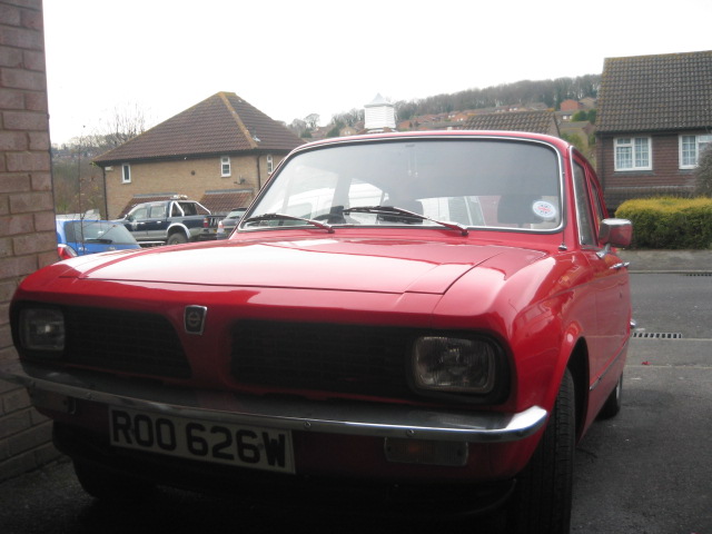

hi guys,am a newbie to dolomites,have just brought a 1500 dolly automatic an ebay purchase with only 35,000 miles on it mechanically good bodywork ok to good but some berk has resprayed it metro red i think it was vermillion originally but i would like some advise on waxoiling it where the hell do i start? :bluewave: :roll:

Your car sounds a nice Dolly...got any photos??

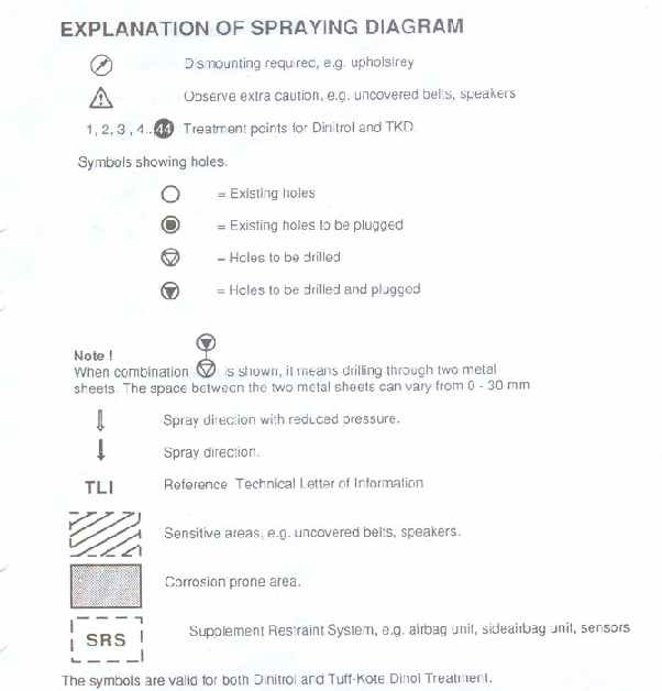

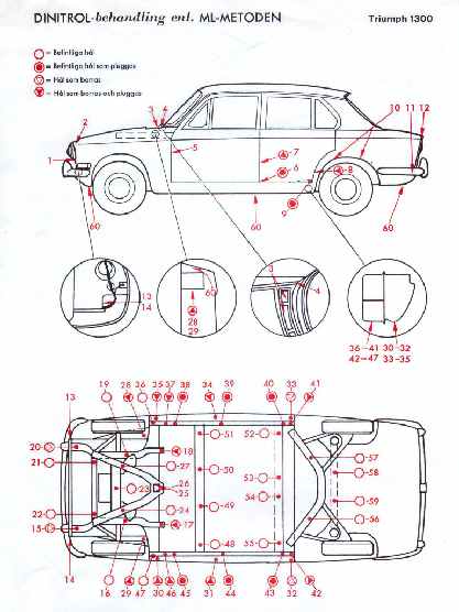

I think I've got a copy of the Dinitrol guide for the Dolly range - shows which holes to spray into, where to drill new holes for spraying and which holes to leave open and which to blank-off. Let me know if you want a copy and I'll scan it in and e-mail it over.

here's some jpeg images of the dinitrol guide, if the quality's no good, let me know and I'll email the pdf file, its for the 1300, but apart from the front and rear subframes its pretty similar for the rest of the range.
cheers
