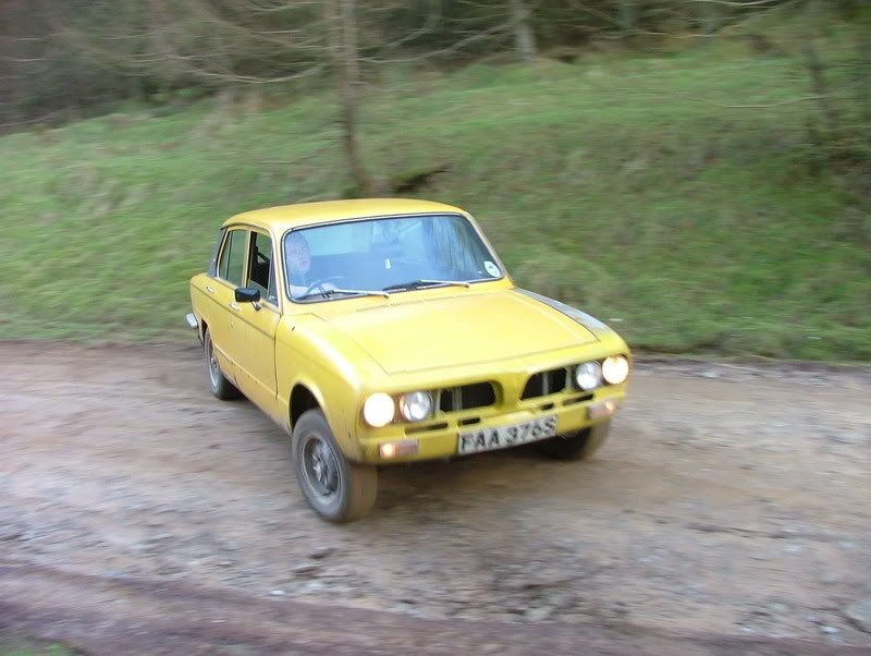

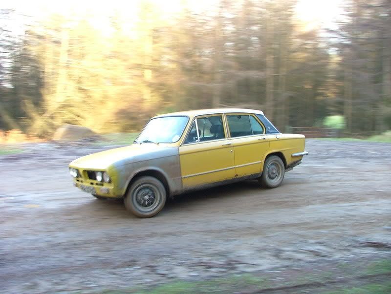

And talking of throttle....
:D
Put
#40 Post by Jon Tilson »
your grills back in Adam...
They are there to stop debris damaging your radiator. Looks like they would be useful on that sort of kick ass terrain...
Yee Haa...
Very Dukes of Hazard...
