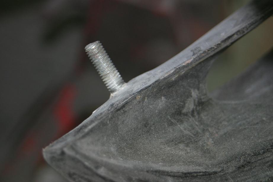

Front spoiler bolts came out when i took it off, i made new bolts up with a welded washer at the end inside, fibre glassed and then plastic filled them in. Their pretty strong now, i done a little bit of modding where they meet the front panel too...

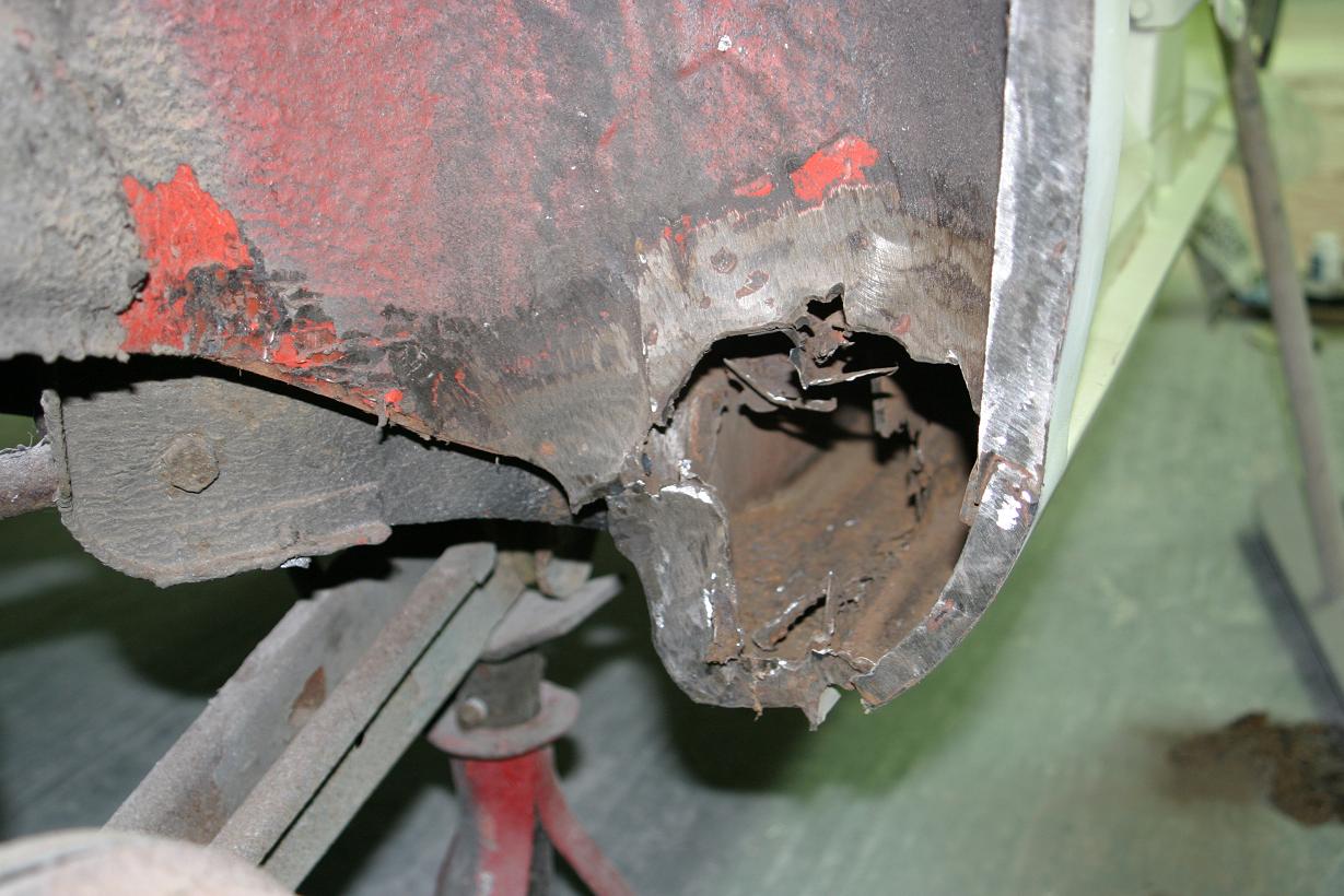

Rear arches had a few holes and various rust that i cut and and welded/rust killed etc...

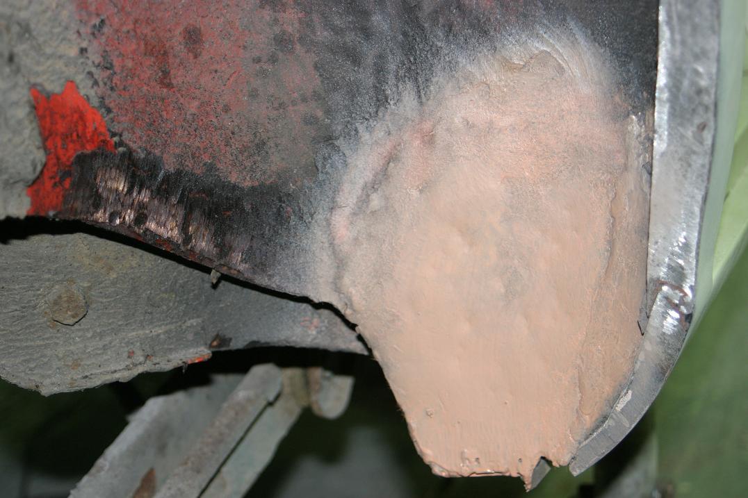

johnnyv1
#123 Post by johnnyv1 »

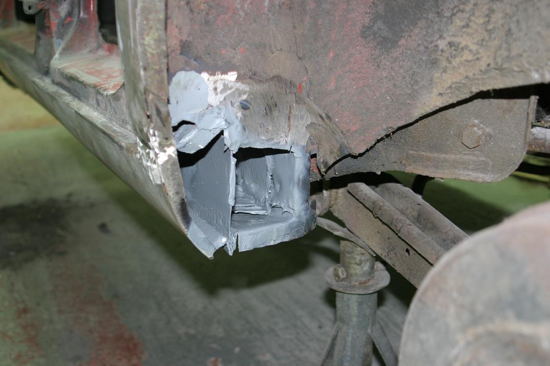

Rear arch sill drivers side, this appeared to be a little rust but i knocked it through and then decided how i would get down the inside the sill to clean it up. :?
Right hand rear arch sill.JPG (138.76 KiB) Viewed 1997 times

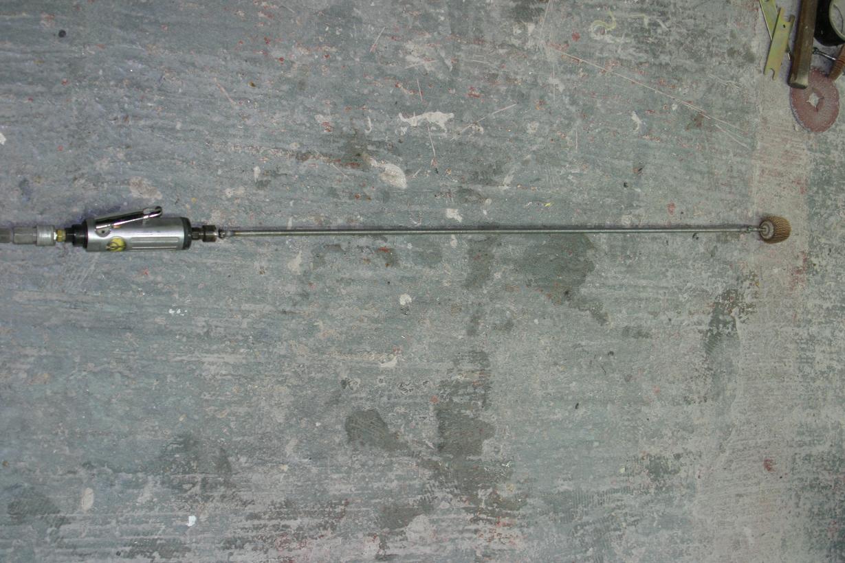

Made up a tool to get down the sills with to clean the rust, got a long bar and welded a sanding wheel to the end as i didnt have a proper holder for it at hand, welded a smaller bolt to the other end to fit in the air grinder. I was able to get down both sides of the sill inside to clean it up,i put on a welding glove to hold the start/middle of the bar as not to burn my hand whilst using it...

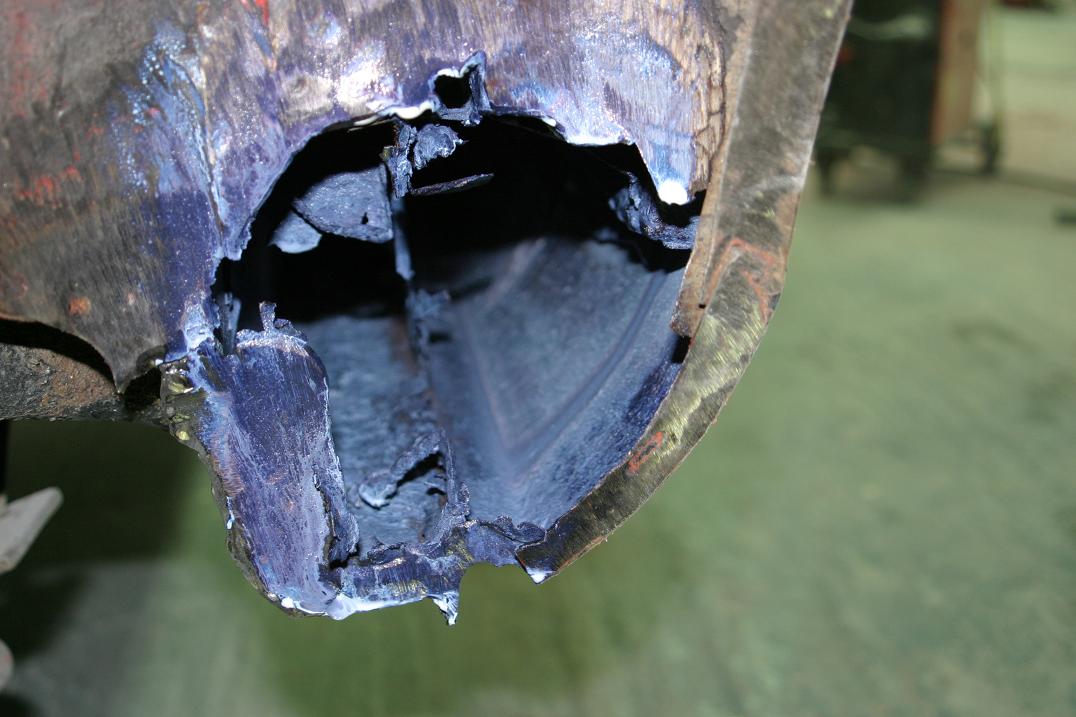

After cleaning inside i sprayed rust killer all down the sills with a mini spraygun with the jet turned to spot rather than fan...

rust killer down the sill

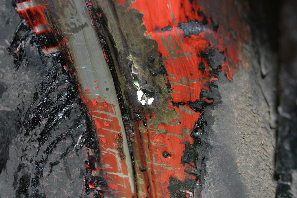

Left side was the same, forgot to say i put a hoover tube down the sills and took out a lot of crap and corrosion after cleaning...
