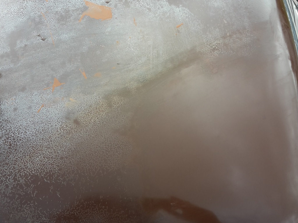

Today I started to sort out the paint the roof. The previous owner had touched up the paint and it wasn't a good job to begin with so when I polished the roof the polish got stuck in the paint cracks. So today I got some 800 wet and dry paper and started removing the cracked layer of paint. Once I got it off with the paper I used rubbing compound to get the shine back then polish. From these pics you can see it's a huge improvement. Luckely it's only the section above the drivers seat coz it's a slow progress. Took 2 hours to just do that corner.

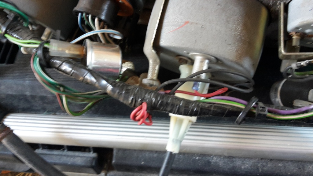

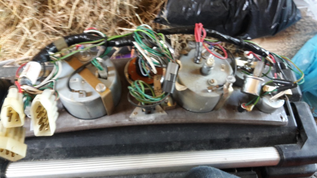

Today I finally fitted my new speedo cable.I had to jack the car up to get to the gearbox end. Removed the instrument panel and managed to get the broken part of the drive cable out the back of the cable. The Mazda speed cable has a bigger mounting clip on the back of the speedo than the triumph one. So this time to stop it snapping again I had to make a spacer to go over the stub on the back of the speedo. The only thing I could find in my garage that was a perfect size was the hose. Cut a short length off and put it on the stub. Cable now fits snuggly on the back of the speedo. I also had to cut the flair off the end of the cable so that it fits through the hole in the bulkhead. I then refitted the instrument panel them fitted the gearbox end.
- Instrument panel

- Back of instrument panel
- IMG_20160704_214541.jpg (189.78 KiB) Viewed 11878 times
- Test fit new cable
- IMG_20160704_214616.jpg (172.1 KiB) Viewed 11878 times
- Hose pipe fitted and you can also see the flaierd end that I had to remove
- IMG_20160704_214648.jpg (171.25 KiB) Viewed 11878 times

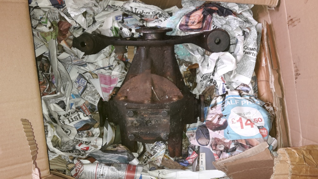

I had a small package turn up today in the shape of a 3.63 diff to replace my 3.89. Just need to find time to fit it and see if it improves the drive now.

You wont want this advice but here it is anyway....
That's a spit diff, so belongs on a spit. Ripping its innards out to stick in an 1850 axle is seriously dim.
You'll have to take off the flange to remove the front support beam, carefully counting the threads as you go and put it back exactly as it was to keep the collapsible spacer intact. The nut is done up seriously tight and I very much doubt you will have the kahunas to get it off without the case being bolted to a Spitfire...
Then you have to take out the little half shafts and get the diff thing off the back case. You need an allen key to do the small retaining bolts - pretty fiddly.
Is there nobody who will sell you a TR7 4 speed axle? Or even an 1850 manual or late 1500 one?

Dear oh dear Jonners, are you getting old and losing your sense of adventure?
An angle grinder will remove the front plate without disturbing the pinion - cut just outboard of the securing bolts!
Dolomite 3.63s are getting hard to find, ditto the early TR7 4 speed diff (which was superceded early anyway)
A Sprint diff will necessitate further modification of Phil's custom 1500 prop. And give problems with oversize rear brakes.
So this is the best and cheapest way of raising the final drive ratio by not-too-much to suit the installed engine.

I was thinking about cutting the mounting brackets off. Had my first proper motorway run today and found the speedo is more out than I thought. Unless every lorry that I was behind was doing around 45mph and easily over took them at 60 and the round trip was 15miles less than what it is my wife's car going the same route. Going to have to sort that out once the new diffs fitted coz it will probably be worse. Also need to get front wheels balanced and think about replacing the exhuast. When I back off the throttle at speed it makes such a bad and annoying noise. Thinking about 1850 or sprint one. The larger diameter should improve the engine running as well.

I'd definitely cut the front mount off, the extra bit of weight won't matter and it means there is no chance of getting it wrong or making a mistake when removing and refitting the pinion flange.
Someone like Fitchetts or Mike Papworth might even give you a few bob for the redundant Spit rear case and stub shafts.
