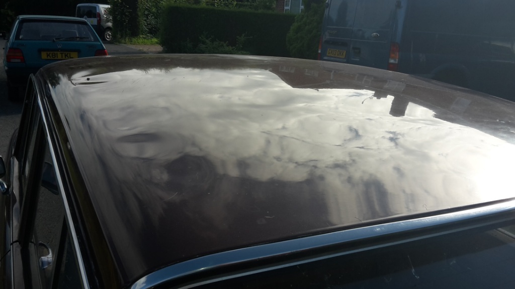

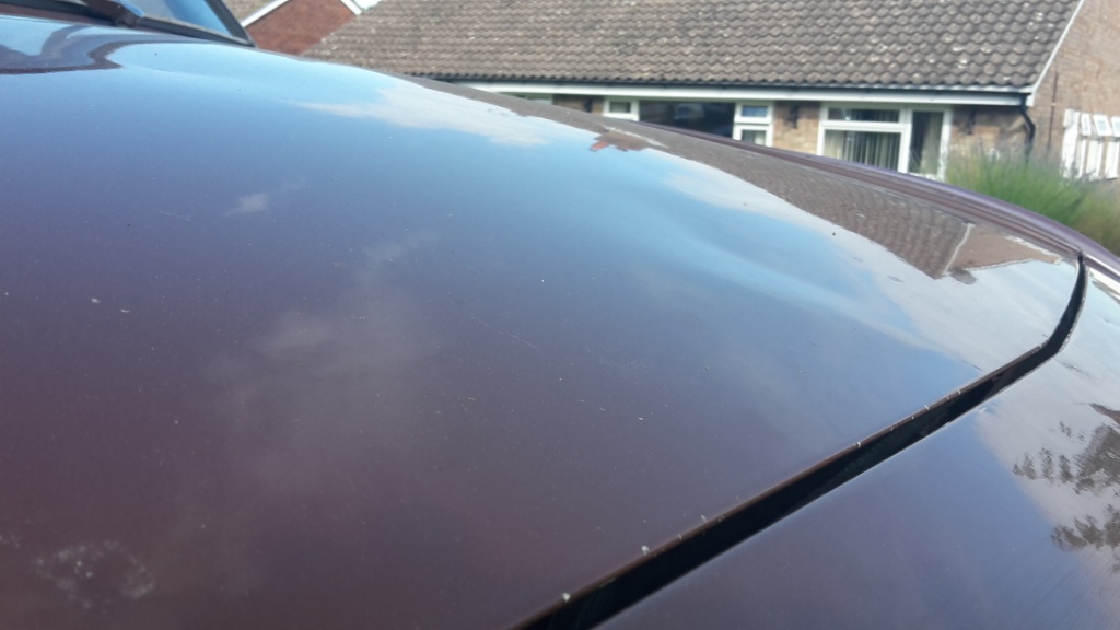

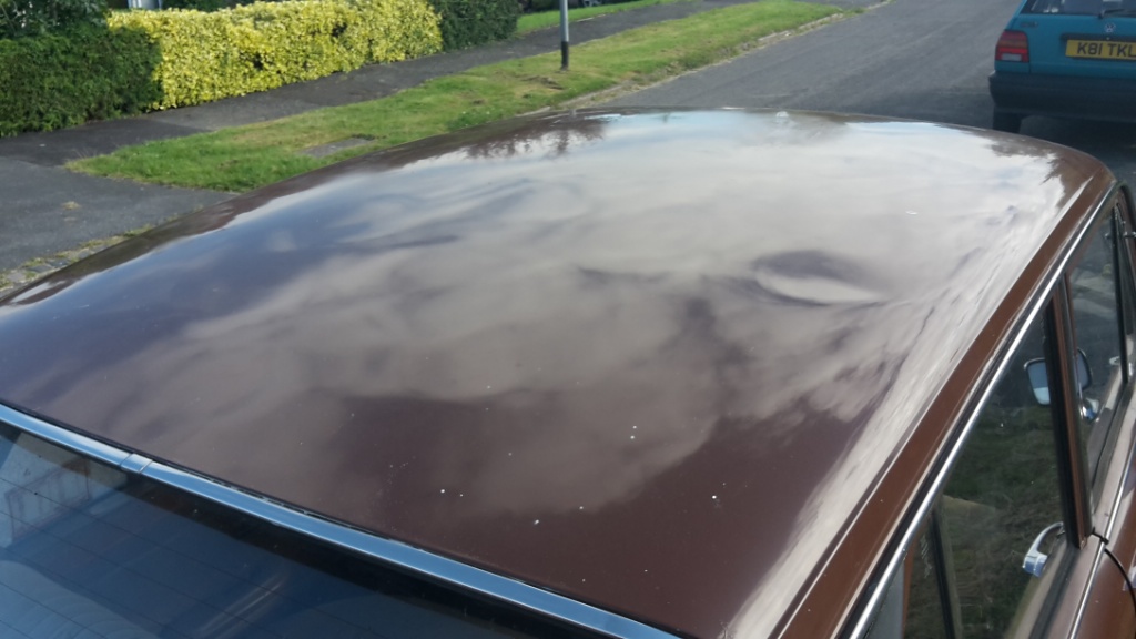

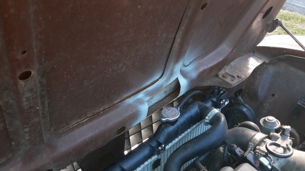

So after last night thanks to an alcohol fueled ar×e hole with no respect for other people's property I have got more work to do on my car. The lovely chap that was p155 off and shouting about picking a fight with someone thought my car was the best thing to take his anger out on! I hope he hurt himself doing it! The roof has got dents all over it and don't know whether the bonnet will be able to be repaired as the skin is dented and has separated from the reinforcement which is now bent and so the bonnet is now twisted! Peed off is an understatement. If I got out there in time I should of followed him home to see how he likes it being done to his car. From the noises it came off a lot better than I thought it would but it still knocks you back and makes you think why would someone do it. Another car on the street got scratched but nothing as bad as mine. Tried to get as good pics as I could.

Please report this and see if you can get a SOCO to come out and print it. Extremely unlikely but the degree to which your neighbourhood is policed properly is down to how much of this sort of thing gets reported. If you can identify the miscreant you can prosecute for criminal damage.
Lots of sympathy and not a lot else to suggest. I expect Alun might have a decent bonnet.

Looking at those dents, it may be worth trying this.
https://www.youtube.com/watch?v=ILVWPzO_swY
I have had varying results but it can work(nothing so dramatic as in the video).

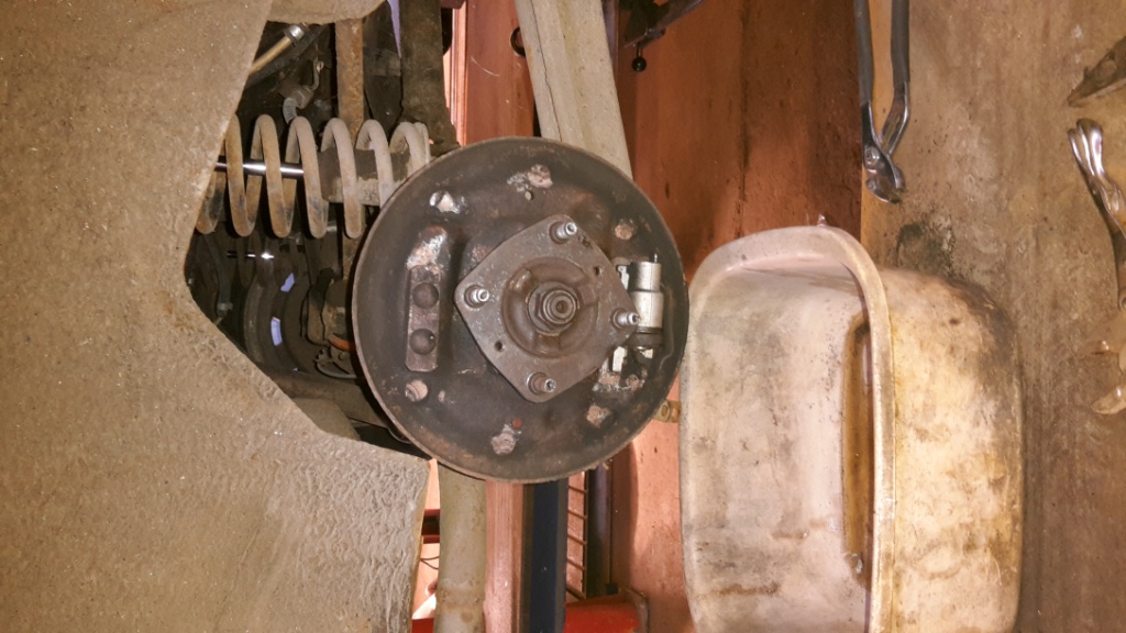

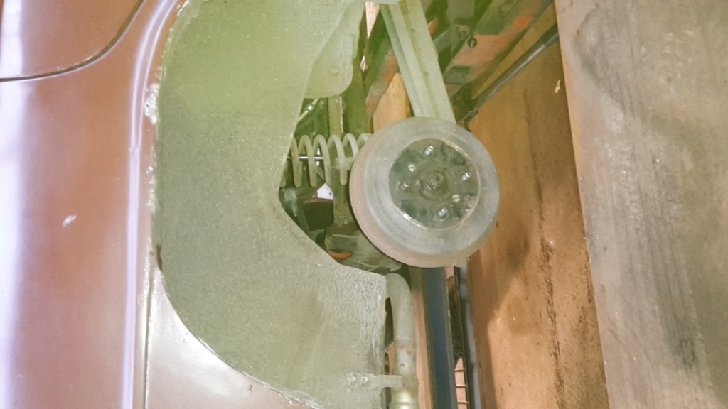

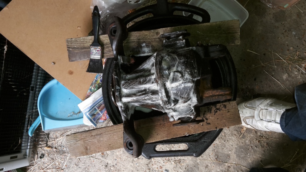

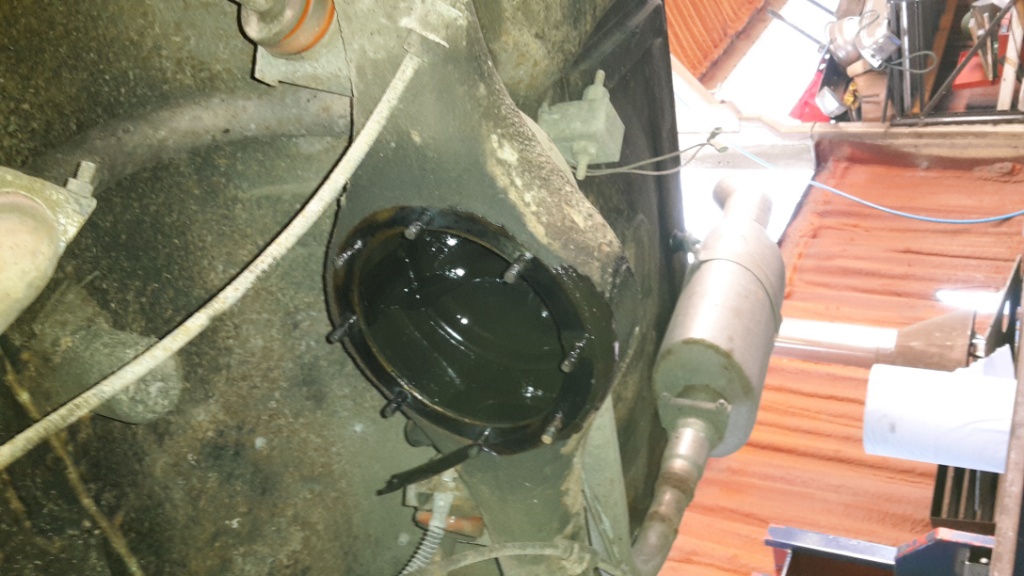

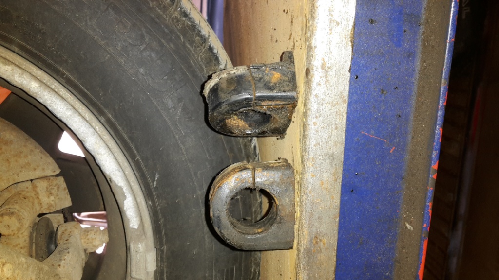

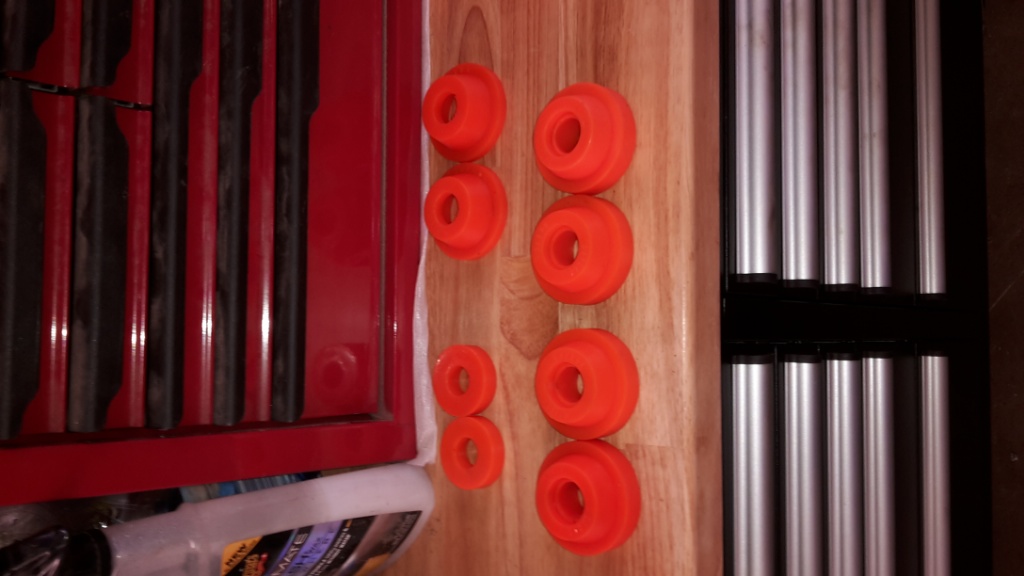

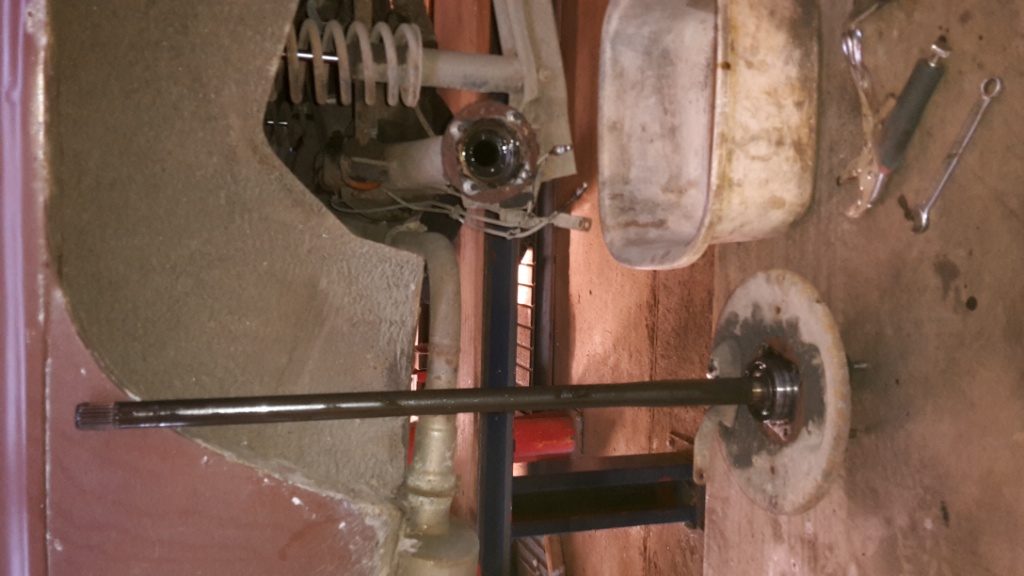

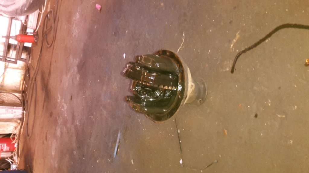

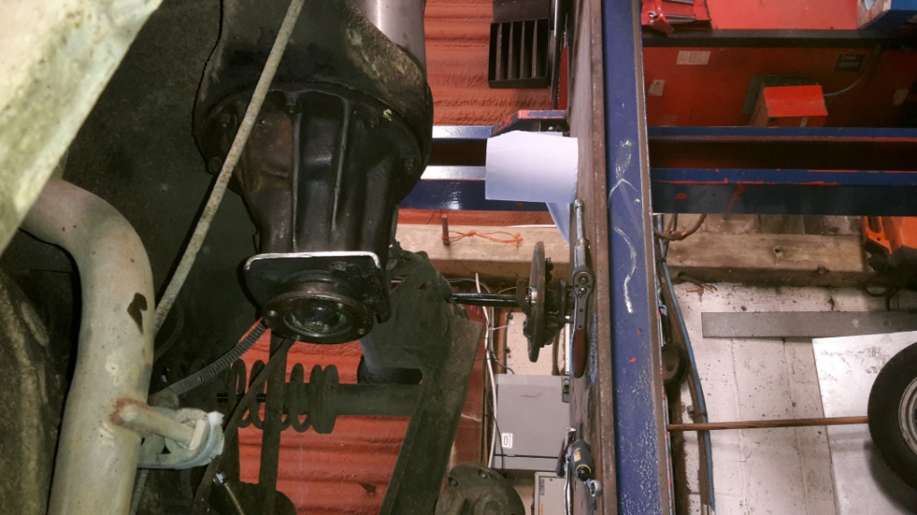

Had a productive day in the workshop today. I got the 3.63 diff fitted. Replaced steering rack bushes and also the subframe bushes. Then even had time to adjust the tracking. With the new diff the car is a lot more drivable, not changing gear as quick and is quieter than the old one. And now the wheels are pointing in the right direction the steering is a lot more responsive.
Wheel removed
Wheel removed
Hub and brake shoes removed. Also brake pipes and handbrake cables removed
Half shaft removed
Half shaft removed
Prior shaft removed
Prior shaft removed
Old diff removed
Old diff removed
Old diff on floor
Old diff on floor
New diff ready to have bracket trimmed
Bracket trimmed and diff bolted to axle
Very worn rack bushes
New sub frame bushes
