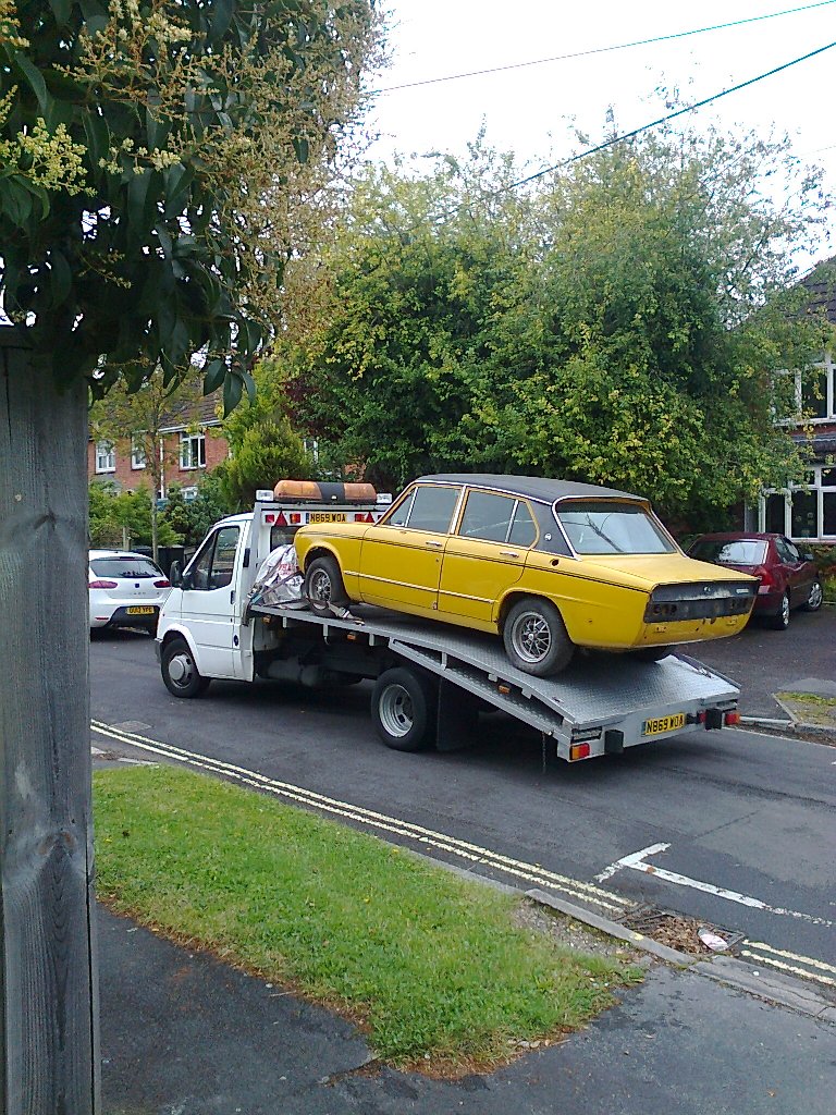

Re: Project VHK (Inca Sprint)
VHK has left Andover, over to you now Mart & Mary, good luck with it.
- Photo0112 (2).jpg (284.19 KiB) Viewed 4284 times
- Posts: 8535
Thanks Tony.
VHK arrived safely just before 6:00pm.
I managed to remove one piece of trim before calling it a night.
