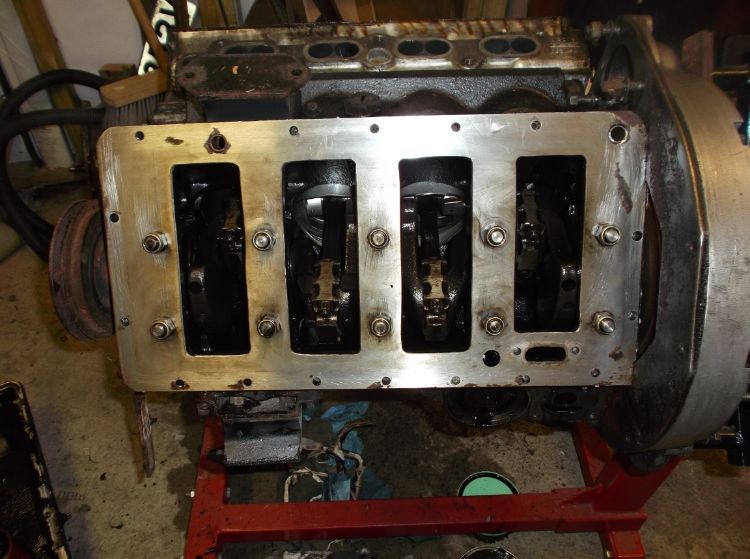

Then I took the sump off to check there were no nasties in the sump, got a bit of a surprise a block brace, looks homemade but pretty substantial.

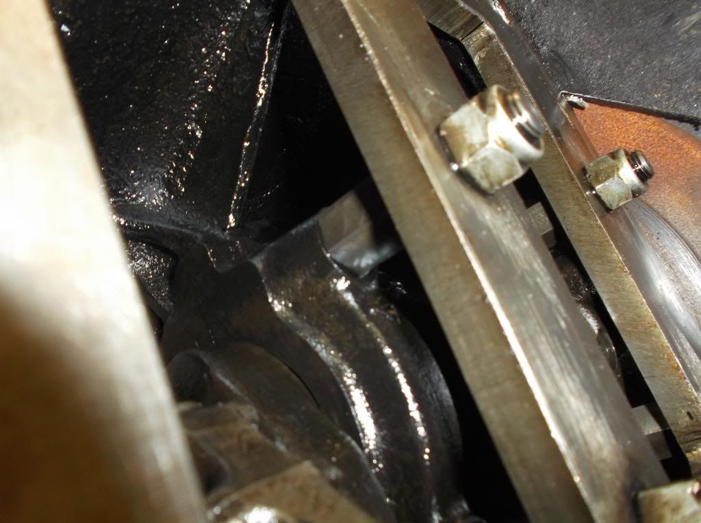

If it is the brace with the long threaded studs and 200 nuts i suggest remove and fit some decent main cap bolts.
Re: MSO 662P
A lot of nuts
There are some thin (about 5-7mm) braces which do not work. Instead of a main bearing cap bolt there's a long stud with a nut, then another nut, then the brace and then another nut. So about 30 nuts. Driving me nuts.....
These braces will flex and do not support anything. For show use only. And the used threaded studs with nuts to tighten the mainbearingcaps are of unknow material and can stretch. So it's better to use std main cap bolts or even better a ARP main stud kit.
Re: MSO 662P
Will have a look tomorrow & take a picture, but it looked to me that it was 1 long nut, definately not lots of nuts.
I think the guy who built the engine in the 80's was quite a good engineer, so I don't think it has been thrown together,
The brace plate looks pretty thick about 10-12mm will measure it tomorrow.
Thanks for the interest Jeroen, bear in mind this engine was built in the 80's & things have moved on quite a bit especially with guys like you with advanced engineering skills.

On the oil pick-up I'm assuming you would need a second gasket between the block and brace?
Re: MSO 662P
Yeah there must be a gasket under the brace. I was also thinking about the dip stick, I am not sure if it has been adjusted as with the brace the sump sits about 10-12mm lower, but the oil pick up is in the same relative position to the bottom of the sump.
So if the dipstick has not been adjusted will I be overfilling the engine with oil if I fill to the top mark?
Re: MSO 662P
No, you only have more oil under the level mark of the dipstick. You did enlarge the sump a bit by adding a brace. The level should stay the same so just a little more oil to have it at level.
- Posts: 8524
Re: MSO 662P
Thinking about it some more. The regular gasket on the oil pick-up is a lot thinner than the sump gasket. Usually this doesn't matter but with the brace the gaskets need to be the same thickness so you may require 2 or 3 under the brace.
