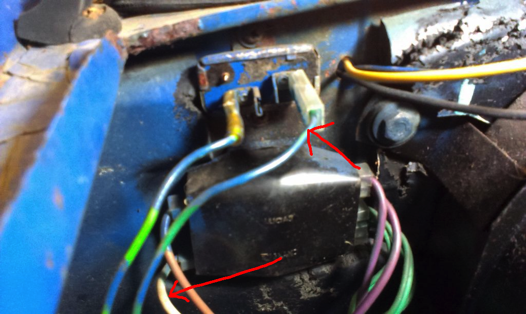

If you put the VS back on the car. Keep the multimeter set to how you described. With the black probe on the battery -ve or known good ground, touch the red probe to each of the terminals in turn. One will give you battery voltage (12V). The other should be around 10V. Remember the casing of the VS must have a good ground.

Thank you, so i did that and the right terminal indicates 11.7 v but the left one keeps moving and changing values. Does that mean the vs is faulty?
Posts: 8535
Re: fixing the electrics on a sprint
#19 Post by Mad Mart »
I may have misled you a bit there. If you have a cheap multimeter it won't be able to measure the outcoming 10V supply from the VS. That's why your values are changing. You see the wire wound around one side of the strip? when you have current flowing from the 12V supply side, that heats up, the metal bends and breaks contact with the other bit so no current is then flowing. No current means the strip cools down and the metal strip bends back again making contact and current flows again. it does this several times per second so a cheap multimeter won't be able to keep up. It works similar to your indicator flasher unit. Only the flasher unit makes and breaks about once a second. If you have a more expensive multimeter with True RMS it will average the reading or a scope would be the tool to get....but I digress.
11.7V is low, should be 12.6V, the same as the battery. Check your battery again and make sure all your connections are clean.

So do this mean my VS is 100% ok and the problem is located elsewhere? I check the 3 fuel tank wires and one of them shows random values,the other shows nothing and the 3rd(smallest and black is ,i believe ground)

Is the VS definitly ok or could changing it solve everything? (as I said the right terminal indicates 11.7 v but the left one keeps moving and changing values)

If you are using a digital multimeter to read the output from an old type voltage regulator you will not get a true reading and it will constantly be changing, you need to use an analogue meter, one with a needle, as that will read the true RMS value.

So I have clean all ground wirings I could find but I still get 11,7 v instead of 12,5v on those 2 cables (dark green and white), any idea why?

It can only be bad ground(s) or dirty connections. Watch this vid from 'Eric the Car Guy' & check for ground & voltage drop.
