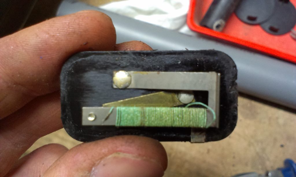

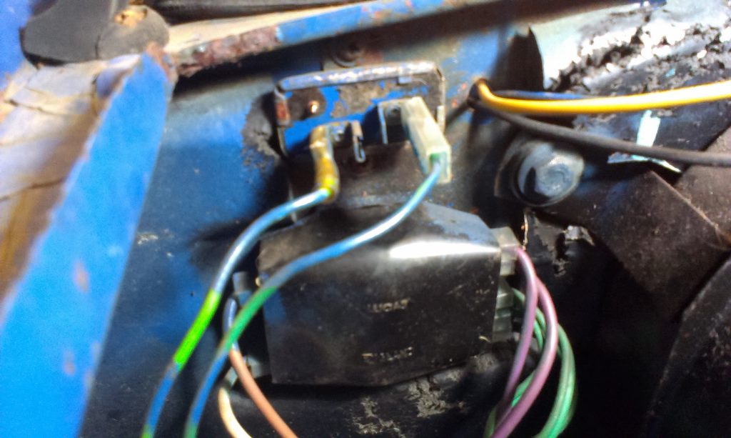

i took off the voltage stabilizer to see if that could solve the problem with the water temperature needle stopping half way up.
But I couldnt really tell wether it is ok or not. It did not show any sign of life with the multimeter, but again not sure I did it right. I set the multimeter on 200 v direct current ( the setting that shows 12.5 when mesuring the battery) and tested where the 2 green wires are attached. Also there are a couple of wires here and which are cut (indicators, fan...not really sure what else, or where to start...)Here are some pictures that may help
IMAG0613 (1024x613).jpg (131.48 KiB) Viewed 1631 times
IMAG0615 (1024x613).jpg (103.53 KiB) Viewed 1631 times
IMAG0616 (1024x613).jpg (94.54 KiB) Viewed 1631 times
Also if I need a new stabilizer could you tell where I could one of these, i tried google but wasnt too sure about the results.
Thanks
Tom
matt of the vivas
Posts: 868
Re: fixing the electrics on a sprint
#15 Post by matt of the vivas »
Same as a Landrover series 2 / 3, readily available from any Landrover specialist, ive just replaced mine, it was a tenner plus VAT.
Matt.
