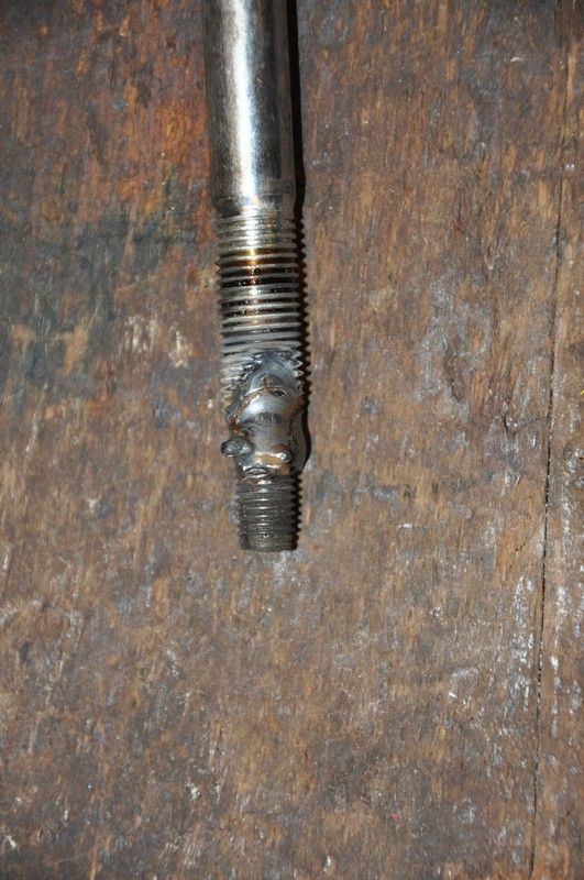

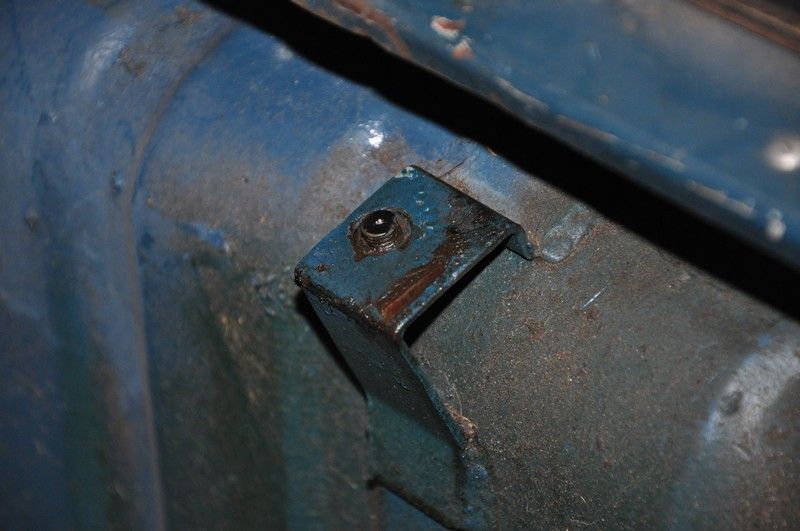

So what work of art did I undertake as my first job? Cill? Wing? Is it as was described of the Lorch - about as hard as squeezing toothpaste? Hard to say having only used about 2 feet of wire extracting a sheared bolt from a GT6 fuel tank mounting.

wiggybum wrote:Julian, were you inspired by the latest instalment of Project Binky:
No, a couple of friends visited the weekend the Tour of Britain started one of whome used to be a machine shop engineer. I asked his advice as the lip you can see here prevented me drilling it out
Even the dentist drill attachment on a dremel is too fat to alight along the axis of the bolt. I did smile when I saw the same trick in the binky vid.
