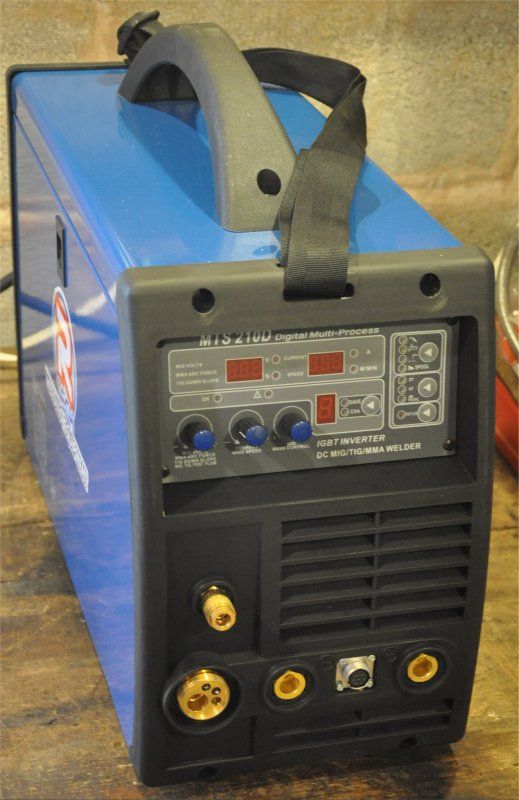

Over a year ago someone whose word on the subject of welders cannot be questioned purchased an R-Tech iMig 160 in the end of season (if there is such a thing) sale. I'd been on the look out for a good welder since moving from Surrey to Gloucestershire in 2012 so straight away I'm paying attention. I need a welder as I used to borrow a friends back in Surrey but inconsiderately the bugger wanted to keep it when I moved. It needed to be a good welder because I'm not. So, immediately I tried to purchase the same model but it was out of stock.
After months of watching the R-Tech site like a hawk it became apparent that the cheeky bar steward had had the last iMig 160, new models had replaced it. Since the new models were cheaper and looked it I was back to square 1. Another source whose welding is superb recommended a Lorch but at well over a grand I'm out. So what to do?
At the next end of season sale I snaffled this, the next model up:

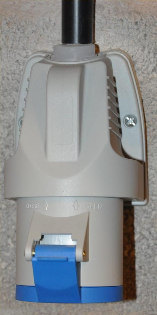

4) One of these for the welder:

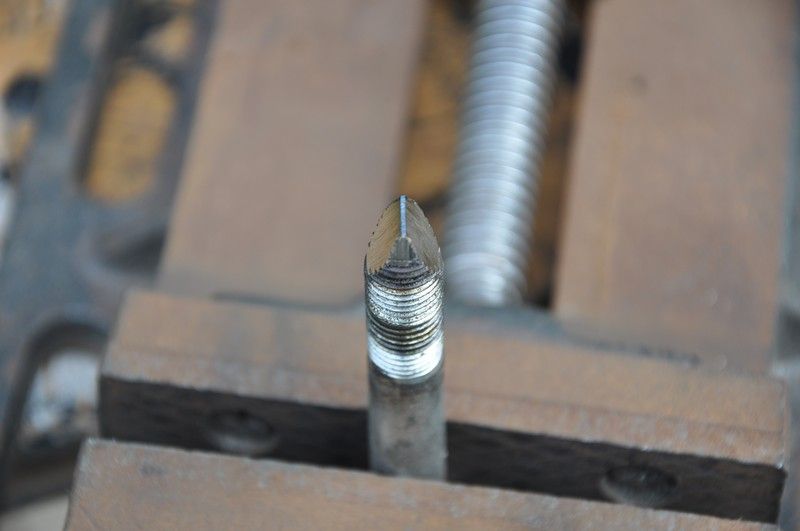

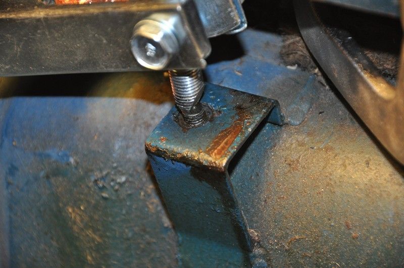

So what work of art did I undertake as my first job? Cill? Wing? Is it as was described of the Lorch - about as hard as squeezing toothpaste? Hard to say having only used about 2 feet of wire extracting a sheared bolt from a GT6 fuel tank mounting.

The socket outlet for your welder is only rated at 16amps so be a bit careful and keep an eye on it. You have said that you are not likely to use the full output but better safe than sorry.

How can you tell that from the pictures Dave?

Edin Dundee wrote:How can you tell that from the pictures Dave?
The socket outlets are colour coded for different amperage ratings,red, yellow , blue. The socket shown is the same as is commonly used for mains hook-up for caravans etc which are rated at 16 amps
Although oddly I've discovered blue can be any of them!..

geeksteve wrote:
I thought Yellow was for 110v stuff!
Ahh, not quite Dave.
Yellow is 110v
Red is 3-phase, either 3-pin or 4-pin
Blue is 230V - I know you get 16A and 32A versions, there may be more.

Jon Tilson wrote:Sweet work.
You should be able to power a single phase 2 post lift with that lot. Is the roof high enough?
If so I'm moving next door...
Regrettably not Jon. Given where you are vs the cost of property round here you could probably swap for a large mansion and a couple of industrial units. Fill one with toys such as that lift and the other with Triumphs.
Edin Dundee wrote:Ahh, not quite Dave.
Yellow is 110v
I thought the same and the pictures on this page agree. It is this one that I requested but as there were other things on the order incorrect I shall check.

Apologies for any mis-information. I am putting this down to medication,age and the fact that I have been out of the Electrical game for a little while and have not kept up with new products and gizmos as much as I would like.

Hi tin, a bit late but next time check out CPC for bits and bobs:
http://cpc.farnell.com/jsp/search/brows ... sults=true
I recently wired a welder using the 16A blue commando sockets, the MK brand were great quality and easy to use compared to a cheaper brand.
