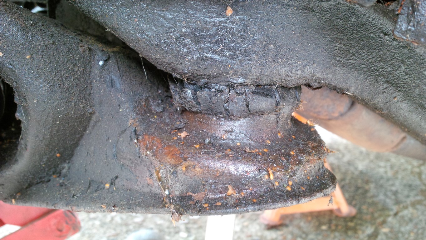

Well, today I attempted to replace the subframe mounts and I think I may have found the reason for the "squirming" feeling.
Here is a picture of the nearside rear mount before I loosened the nut off, you can see it's badly perished, but I don't think this is the reason.
NR rear subframe mounting rubber
NSR Mount.jpg (363.98 KiB) Viewed 1074 times

Here is a photo of the offside rear mount, again before attempting to loosen it off. As you can see it looks very different and there is a reason for that..........
OSR mount.jpg (291.74 KiB) Viewed 1074 times

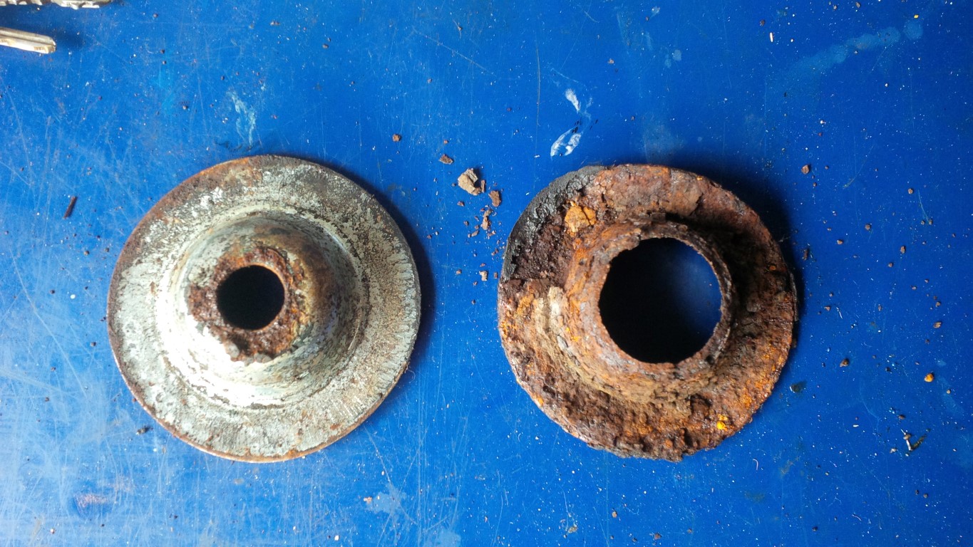

And here is the reason. The offside cup is on the right, you can see that the centre has rotted out completely rendering it inoperative. Effectively there was nothing clamping the rubbers and therefore nothing holding the subframe to the car in this corner at all.
So I need some new cups, but also some help in getting the nut off the bolt on the offside. The nearside played ball and the nut came off without the bolt turning. Unfortunately the same can't be said for the nearside, the bolt turns and the head seems to be behind the steering column UJs - Grrrrrr. Time stopped play today so any help with gaining access to the top of the bolt without removing the rack etc would be most appreciated.

Re: Sprint vague handling
#25 Post by Jon Tilson »
You can get new cup washers from Fitchetts or fit an alternative poly bush that just uses a flat washer.
I have the latter on one of mine and its fine.
I managed to get a flat ring combination spanner on the bolt head under the column intermediate shaft and eventually
it finds something to lock against as you turn the nut underneath.
Usually the cup washers fall off in the road when they get to that stage....

All done, thanks for everyone's help. The handling is transformed.
I managed to wedge an open ended spanner on the bolt head under the steering joints. After that, the job was easy.
