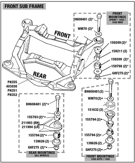

The rear front subframe rubbers look soggy but I cant make the subframe move with said screwdriver. I will be fitting polys here very soon though - could these cause the waywardness?

Thanks for all the suggestions guys.
Subframe mounts are top of my list.
Glen.
Glen.
- Subfame bushes.gif (55.92 KiB) Viewed 1907 times

I have ordered subframe bushes as Mr MOT will not like the look of the existing ones for sure.
