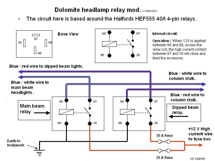

#25 Post by MIG Wielder »
.... here's one I did earlier.
With a couple of typos corrected.

MIG Wielder wrote:.... here's one I did earlier.
There is a typo in that list. You're making two connections to terminal 30 and none to 85.
