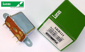

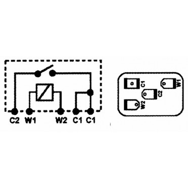

Pictures might help, so I've gone and stolen some!
Here's the SRB111, you can see that one of the outputs at the bottom right is just a double Lucar, that's C1 and the output for your lights:
And here is a what it actually looks like 'under the hood', and you can see that C2 is your main feed, the equivalent of a modern 30 pin, and C1 is the equivalent of 87 and 87b.
