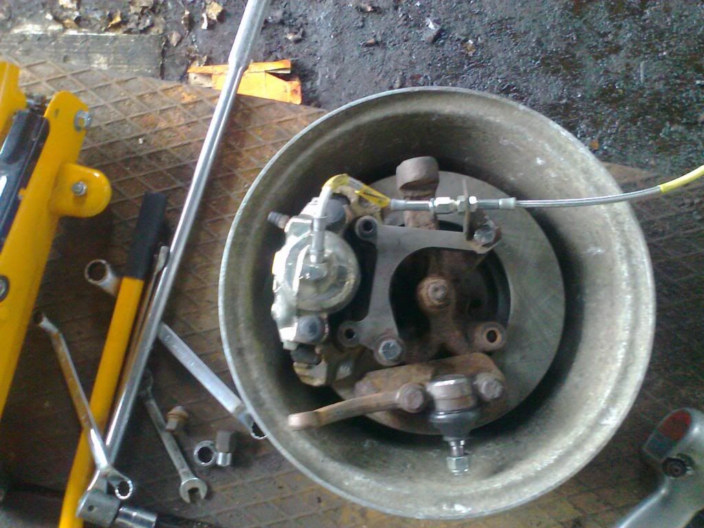

I had 5 sets made by Goodridge and still have a couple of sets left. Unfortunately a slight design error (by me) means you have to move the mounting bracket from the balljoint nut to the front bolt of the TJ bracket and shorten it a bit. However i've had a set on the Carledo for 3 years now without problems of any sort. They come out at £30 a pair + postage.
The next lot I get made will address this problem. Not sure when that will be though.

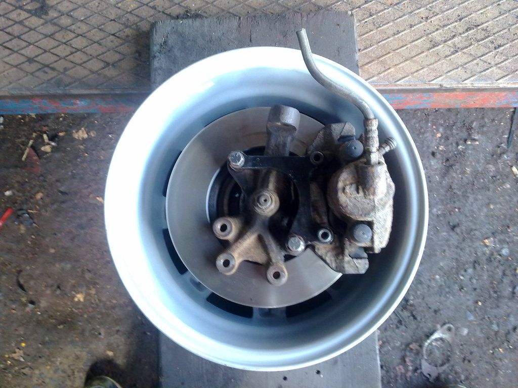

These are the Goodridge hoses I had made and how the modified bracket position works, also shows how the TJ kit fits inside a Sprint rim.
The next sets I order will have a 90 degree elbow out of the caliper and a 45 degree one at the front, which will allow the original bracket in the original position to be used.
And this is my oversize mod with 256mm Passat discs and 2001 Puma calipers, carriers and pads, shown within a 14" JBW fake minilite.
