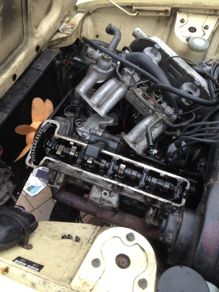

Ok so an update, 5 hours in I have the coolant drained, manifolds off, timing chain off head, 5 head bolts out, 5 nuts and 4 washers off the studs. When I took the spark plugs out, they were oil fouled, which is a bit scary. Hopefully I didn't overheat the engine?!? If I have, would replacing the head solve the fouling, or is it the engine block?! Just waiting on Plus Gas and I will attempt the studs. scary stuff!

Good progress ! I imagine you took the photo before you had finished ? I see the front cylinder head bolt is still in.
It actually helps quite a lot to have the exhaust manifold still attached to the head but disconnected from the exhaust down pipe I found, because you can put a trolley jack with a long wooden chunk of timber underneath it to help lift the head.
I'd also remove the heater blower and the large rubber connecting pipe ( 3 bolts) and a large Jubilee clip and just rest it above the bulkhead so access to the rear stud is slightly better.
In some ways its good news that there are 5 head nuts but only 4 washers. It means the head has been worked on previously maybe ! It may come off very easily ! That thick washer will need replacing though.
Don't worry too much about oil fouled spark plugs at this stage.
Was the car pushing out much oil smoke when warm on the over-run ?
If so it could be valve guides, that can be replaced while the head is off; or just the valve stem oil seals. They can be easily replaced when you decoke the head.
If its coming up from the bores then that is a different matter for later.
One question for Jonners. Are there valve stem oil seals on the 1850 please ? I cant see them in the parts book.

Thank you Tony. I did indeed take the picture before I finished!
I struggled to get the angle needed to remove the downpipe, so I've removed the whole exhaust manifold. Now I've broken the corrosion on it it's not as much of a problem - I re-attached it a couple times to use it to lever the head bolts out. The long bolts were particularly stiff, and I managed to bend the wrench extension getting the bolts out!
I did wonder about access to the rear head stud. The bolt was a pain, I can only imagine what the stud will be like?! As for the bolt washer, I do have 5, I'm just still fighting with the last one. It's completely caked in.
When I ran the car, it had huge clouds of white smoke when I pulled up at traffic lights, heavy smoke that would stay when I drove away. Didn't look blue to me. I will see what it all looks like (hopefully) soon on the inside.
