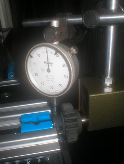

As a matter of interest the Haynes manual gives figures on measuring the individual gears endfloat on the bushes. Is this how it is done please ? See photo. The new reverse gear shaft is in the plastic jaws of the Workmate with a magnetic dial gauge on the end of the shaft . I can then push the gear upwards and get a reading of 0.05 mm = 2thou ?

- rev gear end float.jpg (61.84 KiB) Viewed 2455 times
Re: Dolomite 1850 bell housing casting number ...
Looks like you are measuring up and down?
End float I take to be along the shaft. In the case of the revers cog its just located by the selector so it cant touch bits it shouldnt
when the whole lot is spinning.
If you keep the gears with their original bushes you should be fine. They would have been measured at the factory. I only check if I need a new
gear as the old one has teeth missing. Even then I have never found one out of limits.

Yes, thats right; I was measuring the up-and-down movement of the gear on the shaft.
I shall stick to left/ right endfloat checks.
