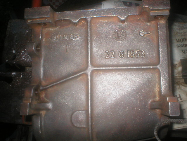

Its going to need a lot of work whichever one it is. The external casting has a lot of surface rust.
The main casing casting number is 22G 1553 on the side .
Where I expect to find the gearbox number is a W? 0950?3? number.
The input shaft has the fine splines.
No gear lever.
I can count the number of teeth on the cogs if that helps.
The bell housing has an 1850 style casting for slave cylinder ( one broken stud / bolt ) but the main casing has the side fixings for what I think are the 1500 slave cylinder.

Re: Dolomite 1850 bell housing casting number ...
Ah now I can help.....
That looks to be a single rail box from the side pics and the spline count and the bell housing will be alloy if its for an 1850 with the clutch slave
mounting top and drivers side with box in the car. OHV cars have a cast iron bell housing and the slave sits low down on the passenger side.
In both cases the slave mounts on the bell housing and the case is clutch agnostic.

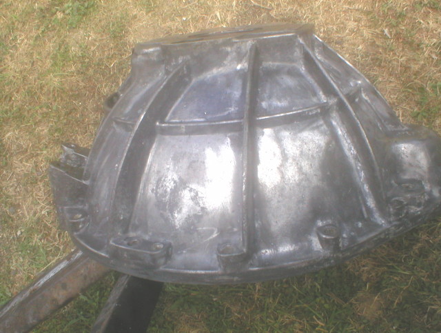

Can we have a pic of the top to be sure...

Hi Jon, Thanks for that. I made progress today. I had a 2nd pair of eyes on the gearbox number and the 2nd character is an " M" with 2 vertical sides rather than 4 sides at 45 degrees. So that is probably a " WM" serial number. Yes the bell housing is alloy and looks very similar to what I already have on my 1850.
Here is a piccy of the top of the bell-housing.
So its good news and I've started on dismantling and cleaning.

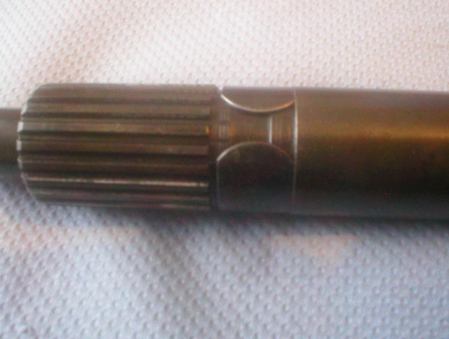

I have the early and late 1850 parts books and have found 3 anomalies on the main shaft. Now bearing in mind this is an overdrive box I have some questions.
1. At the front end of the mainshaft is a ball bearing which seems to be press fitted into the mainshaft. It is not sprung. Does it need renewing ? What does it do ? It seems to be under the front cog;

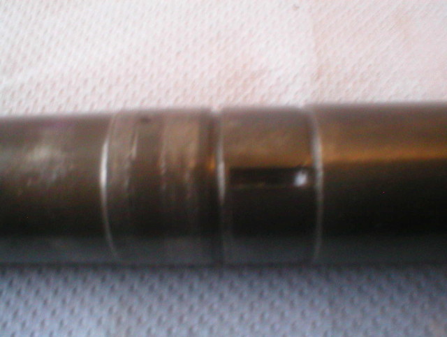

2. About 2/3 the way along the shaft is a keyway cut in the shaft. There was no key in it and there isn't one listed in either parts book. Do I need something here ?
3. There is an oil hole here which seems to connect with an oil gallery running to the back end of the shaft. How does oil get in here please ?
4. At the end of the shaft just in front of the rear splines is a snap-ring. Not listed in the parts book. I've left it for now as if it breaks I wouldn't know where to get a new one. What does this do as well please ?

I have never changed or worried about the ball bearing. I think it helps locate a ring of some sort?
The keyway is essential as this is the thing that hold the overdrive oil pump cam to the shaft. You can get the keys from Moss. Do you not have the pump cam?
That funny spring clip in the end photo doesnt seem to do very much except help get the snap ring on that holds the oil pump cam in place. These are not a lot of fun to fit...
I always leave these on but I think Moss also sell them.
I hadnt noticed the oil hole...probably worth a poke with some wire to make sure its clear,

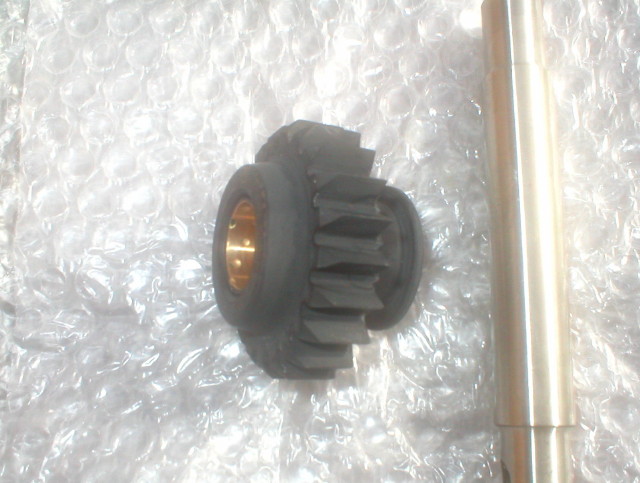

So first thing to go in is the reverse gear idler and spindle.
The old one looked a bit worn so I've got a brand new one. This is coated in a black compound that doesn't wash off with brake cleaner solvent. Is it meant to be run like that or what do I need to clean it please ?
Thanks ,
However I'm now back on this mini-project having got the casing machined nicely.
