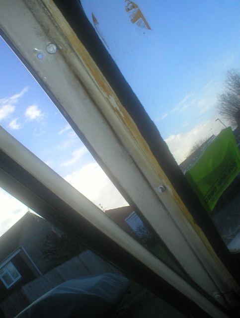

This is my solution to the A-pillar rusting. The grommets are white pvc from one of the suppliers at the Resto; Show.

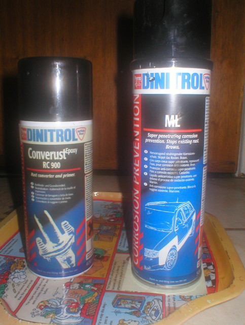

And the spray-cans are my preferred rust killers and protection. Other equally good cans are available.
