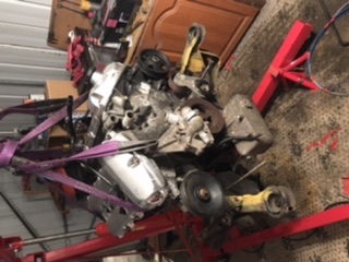

2021 update:
Almost Zero progress made from last time, but got an engine crane to help with it all. Spend ages aligning engine and subframe. So hopefully going to do finish the engine mounts this week, fingers crossed.
Also treated myself to a pair of SprintSpeed Ford patterned stub axles. Haven’t fitted them yet as I want to get all the hubs and stuff first so I’m not stuck with parts that can’t go together if the car needs moving.
My garage is slowly become more filled with stuff and it’s now getting very in the way. Most of it will need moved when the car comes home anyway so maybe after engine mounts, it’s time for a new shed.
Also, at the end of my thread asking about Triumph 2000 drag links being an acceptable replacement for the Dolomite ones, I found a pair of dDolomite ones on eBay and bought them. Came with rubber bushes, nuts and washers. So they’re all painted up and ready for firmest once all back in the car.

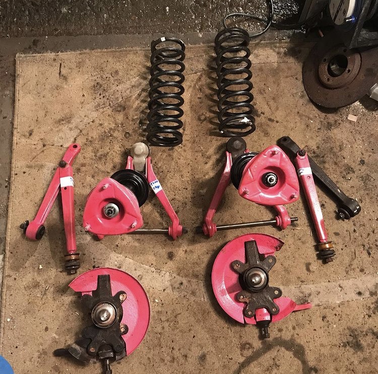

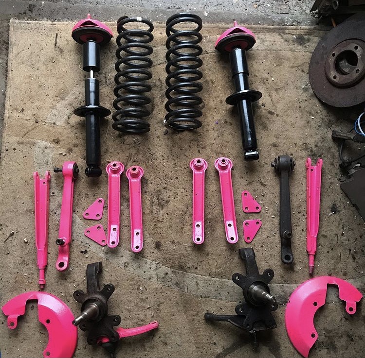

March Update
Well, one year of lockdown has passed and I’ve made so much progress since March last year.
I’ve added more weld to the subframe mounts but it not happy with them. I had issues with my welder settings but they’re strong enough to hold the engine for now. I’ll have to go back and grind the bad welds out but I can do that later.
I’ve painted and reassembled the front suspension, I just need to put the new springs onto the shocks and it’s ready to go on the subframe.
I’ve knocked together some radiator mounts, tied into the old lower radiator mounts and the bonnet hinge mounts. The radiator I’m using is out of an 01 plate Yaris complete with fan, it’s a touch in the small side but fits in the engine bay nicely between the frame rails.
Once I’ve got the subframe back in the car, I can then start to mock up a gearbox mount to attach to the floor area around the gearbox cover. I asked Carledo for advice from his mounts and it looks like it’s a suitable place to mount to with a spreader plate.
I’m still stuck with the axle, as I now have a scrap worthy Koln axle and the weak banjo axle. I’ve debated having some spacers made to use an English differential, as the Koln is very similar to both the Atlas and English axles. This would just be a stop gap while I either buy a strong English or build an Atlas.
I’ve also acquired an X Type wiring loom to cut up and make a harness for whatever ECU I use

Re: Jag V6 swapped Dolomite
Pretty in pink.
Are you sure that Yaris rad will be big enough to cool that big Jag engine.

- Posts: 402
Damn nice in pink, only shame is the paint doesn’t stick well
And yeah, it’s about the same size as a polo rad that westfields use. Main benefit is the fan and shroud making the capacity way more than the triumph ones
