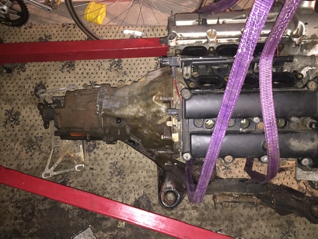

- Jag engine in Dolomite Subframe
- 7E76986C-D7EE-4CBF-89E6-F9418B7D29BF.jpeg (108.46 KiB) Viewed 360788 times
- Jag Engine on Dolomite Subframe
- AF256AEB-0DEA-4E83-8318-8728CE9EBBC9.jpeg (140.97 KiB) Viewed 360788 times

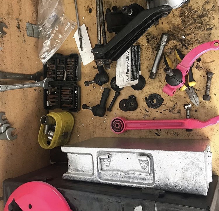

- Suspension half painted
- 01883B96-5F9E-4E25-801A-3B10A98AE1EA.jpeg (254.4 KiB) Viewed 360785 times
- Axle comparison, Atlas at bottom, banjo dolomite at top
- CCB05EFF-79AB-4057-B4EE-957FEB3E60B8.jpeg (132.23 KiB) Viewed 360785 times
- Front suspension in primer
- C60B3F32-5614-4BBC-83C0-BEE804C8EBD4.jpeg (96.87 KiB) Viewed 360785 times
