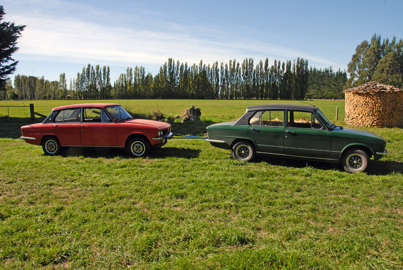

The towing regulations in this part of the world are clearly quite different to what you have in the UK as is evident in the photo below.
It is legal to a-frame a car here that is both unregistered and without a warrant of fitness – your equivalent of a MOT. When I am towing I do run a cable from the tow car to a “trailer board” sitting in the back window of the car being towed which shows both brakes and indicators.
It is a requirement here that all cars must have a warrant of fitness before they can be registered and driven on the road.
Recently I completed the restoration of the chassis on one of the Dolomite Sprints which I have been working on, on which the registration had lapsed. In order to re-register the car had to be taken to a special testing station where it underwent a very extensive Vehicle Safety Check.
I checked with the Inspectors who gave me two options on delivering the vehicle for checking. Either I delivered the car on a car transporter or I could a-frame the car to them, leaving as I pointed out the a-frame mounting brackets which were bolted to the front bumper.
I chose the latter method, for it was much simpler to do. The inspector spotted my previously restored Sprint HU 5000, the tow car, and was satisfied that the Sprint HU 5089 being returned to the road will finish up in the same condition.
The question of towing weights was never raised.
What I had to do to satisfy the inspectors will be covered in a post on my thread on HU 5089 Dolomite Sprint Restoration shortly.
Robert
