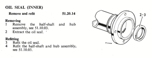

I managed to find an old battered cold chisel that by pure luck tapped in just enough and I managed to twist it out enough to get some leverage behind it. Jonners posted something awhile back about a homemade tool he concocted to hoike it out easily. Actually, think it was him that also said that the outer hub seals very rarely go, and they are the ones that need a ships torque wrench and puller to shift!

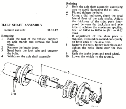

Yeah you're right, there is no gasket, just the metal shims that sit behind the backplate, apparently, you need to check for the right endfloat, I went with they have been on there for 42 years I'm guessing it's right.
Here are the relevant bits from the Triumph ROM, no idea why it mentions 51.10.03, doesn't seem to exist!
- oil seal inner.png (42.63 KiB) Viewed 2729 times
- remove half shaft.png (133.14 KiB) Viewed 2729 times

Remove the wheel and brake drum, knock back the locktabs and undo the 6 bolts 112653 then simply pull the shaft and hub assembly out of the axle case. replace the inner seal which is in the axle case with the front gearbox seal 141756 and reassemble. Seemples!!!shaunroche wrote: ↑Tue Oct 10, 2017 2:55 pm I don't believe this, surely you need to take 58773 off and undo bolts 112653 etc and pull the half shaft out before you can get at the inner oil seal?

When you undo the bolts holding the hub and backplate on,the half shaft just pulls out then the inner seal is visible in the axle tube. Change that one. The outer one is just to keep grease in the hub.. Dont lose the shims!
