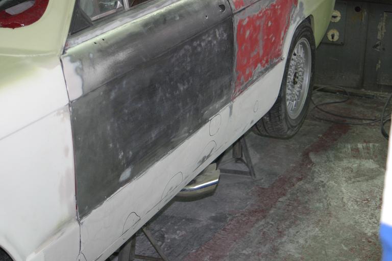

Also I've sorted the sills to meet the doors, i finished welding up the doors where they were rusted through etc, and i gave the bottom of doors and sill a final light skim of filler to smooth and flush the lot.

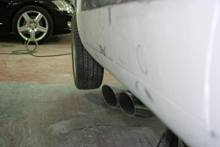

See pic for example of exhaust.
- IMG_4784.JPG (57.65 KiB) Viewed 1407 times

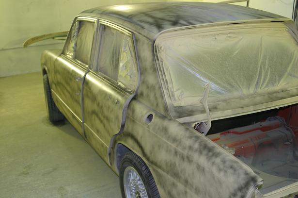

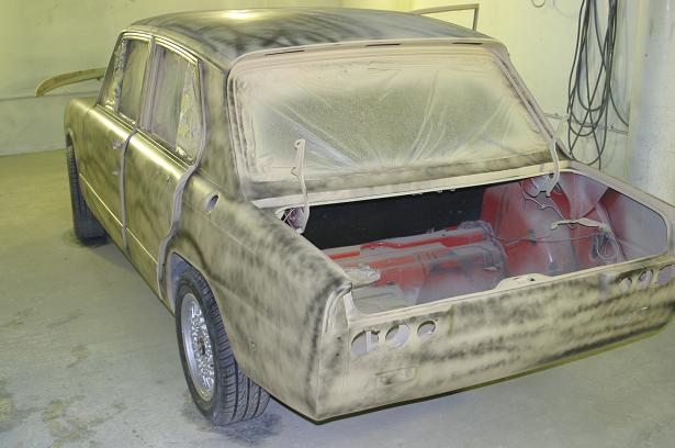

Primed!!!!!!

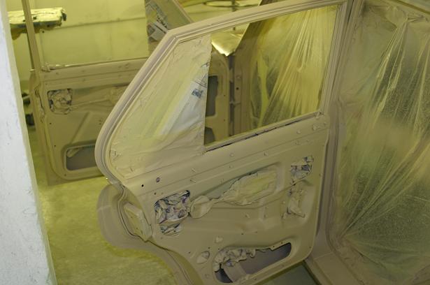

Its amazing what a bit of primer can do to a man's heart. Its now all primed, done a bit of flatting,still need to do more before paint, haven't flatted the bonnet or boot yet either. Still, as soon as i got it all primed it made me feel better to see her relatively one colour. I removed/treated all the rust inside doors and primed them also with the rest, it had a yellow door,a red one,a green one,a red/green one,so now they're also all one colour now which pleases me.
Still have a bit to do before final paint, going to try and put it on as nice as possible because i wont be flatting back and polishing it up until awhile, as i want to try and do as much mechanics as i can before the 31st. So i will polish the paint after a few weeks when i have sorted all the more needed stuff.

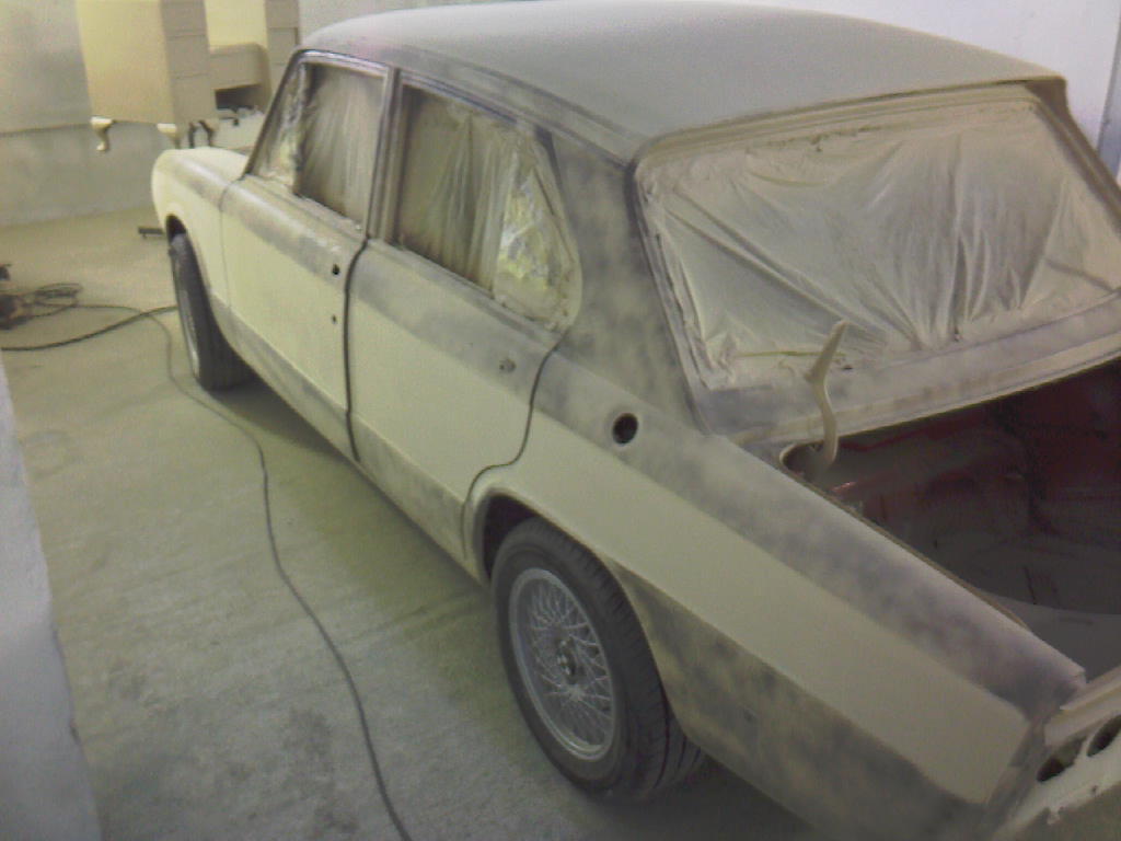

I went excesive on the guide coat i know but its better cause it lets me know if i've missed any bits.
- IMG_4842.JPG (41.32 KiB) Viewed 1089 times
