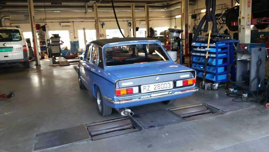

EU- test ok (MOT).
Anyone know how many LHD sprint's made?
