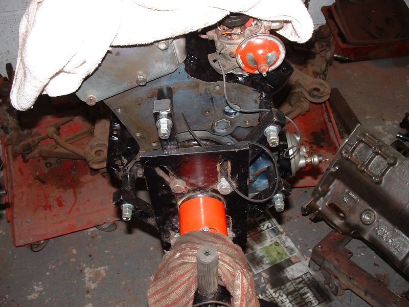

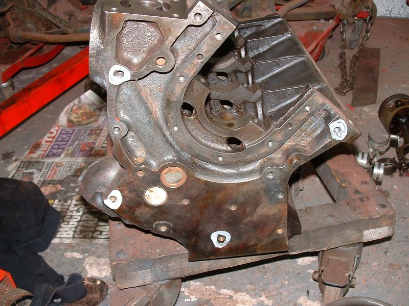

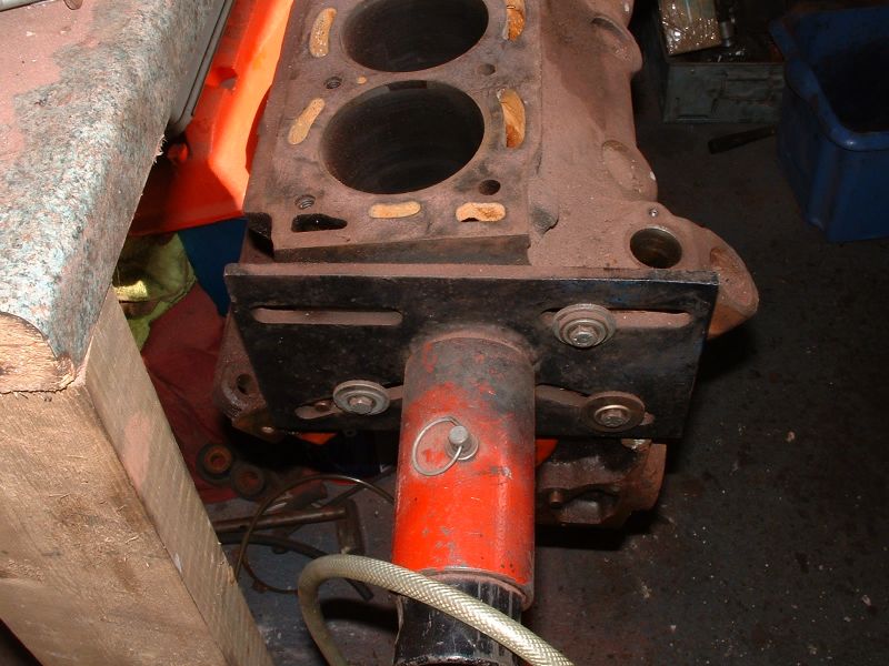

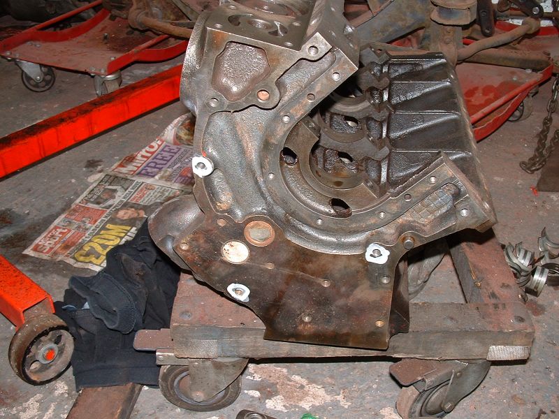

Mart, what backplate holes do you mount the engine stand into? I'm still trying to work out the best ones to use, mine doesn't line up well.

#168 Post by Mad Mart »
I'll check on the mounting holes & get back to you later.
Thanks for the compliment, I think you are doing a superb job with your own restoration. A must watch.
Posts: 8529
#169 Post by Mad Mart »
This is how I've always mounted my engines...
My neighbour gave me his engine stand so I mounted the engine like so...
#170 Post by Jon Tilson »
Interesting...I do much the same
If you look at the dutch guy who did one recently he used the side mounting holes, which I thought was interesting.
Means you can do more on the stand at the flywheel end, but the bolts look a bit small for my liking.

Jon Tilson wrote:Interesting...I do much the same
I noticed that too - but in my eye's it looks bit hap hazardous - accident waiting to happen. Would you fancy working on your engine at that angle.
viewtopic.php?f=19&t=28143&start=30#p267038
Paul

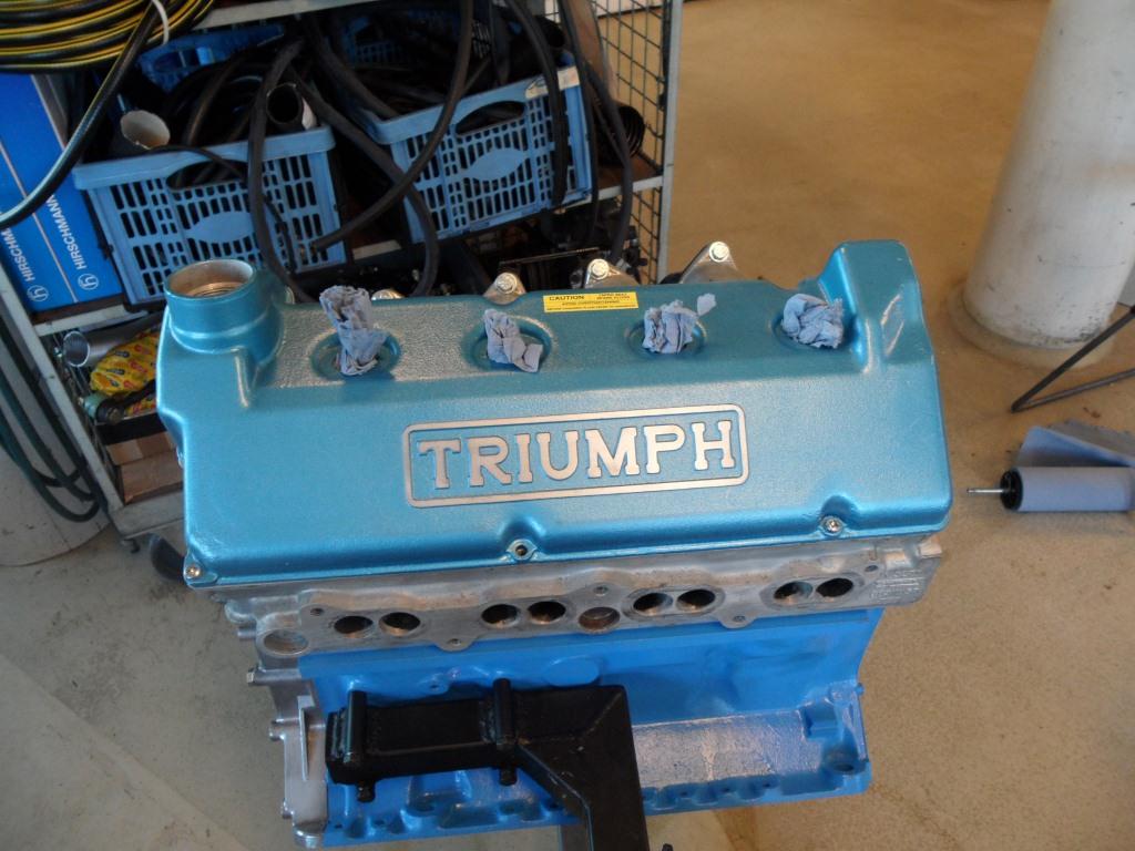

#172 Post by soe8m »
The other Dutch guy uses this type and never one fell off.
But in case one does he wears this for safety:

soe8m wrote:The other Dutch guy uses this type and never one fell off.
Jeron
Well thought out sir - any further details of bracket
Paul
#174 Post by soe8m »
viewtopic.php?f=4&t=28355
Here you can see some details. Make sure make it long enough and in the centre for easy turning. Fittting it on this side and this way the weight is even and the deck face level what makes it easy to fit the head and do some measurements. On the other end i did weld a big plate what does fit the original stand.

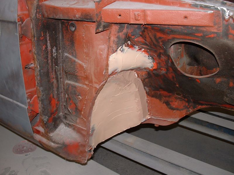

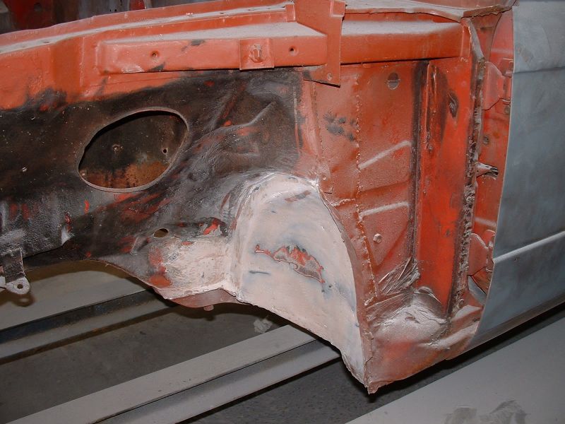

Here are a few pics I took at the sprayers the weekend before last...
Not much progress to report although there should be a fair amount by this weekend. :|

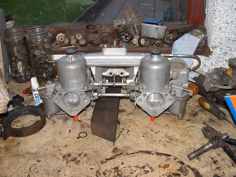

#177 Post by Mad Mart »
The carbs are now back together. Thanks to Malcolm (Magenta Auto Sprint) for sending me a pair of throttle discs. :thumbsup:

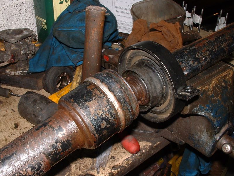

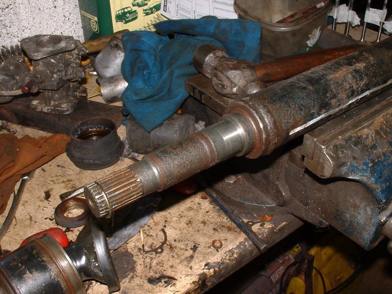

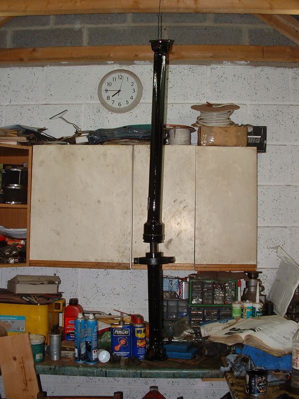

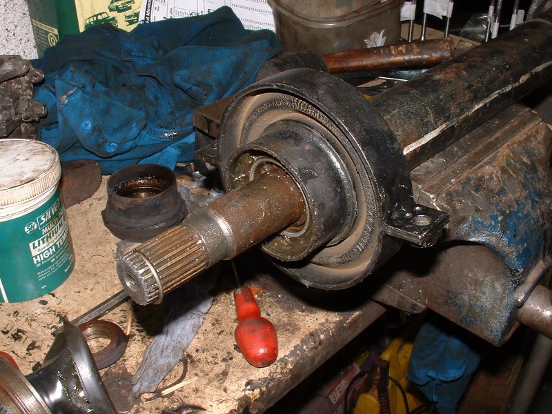

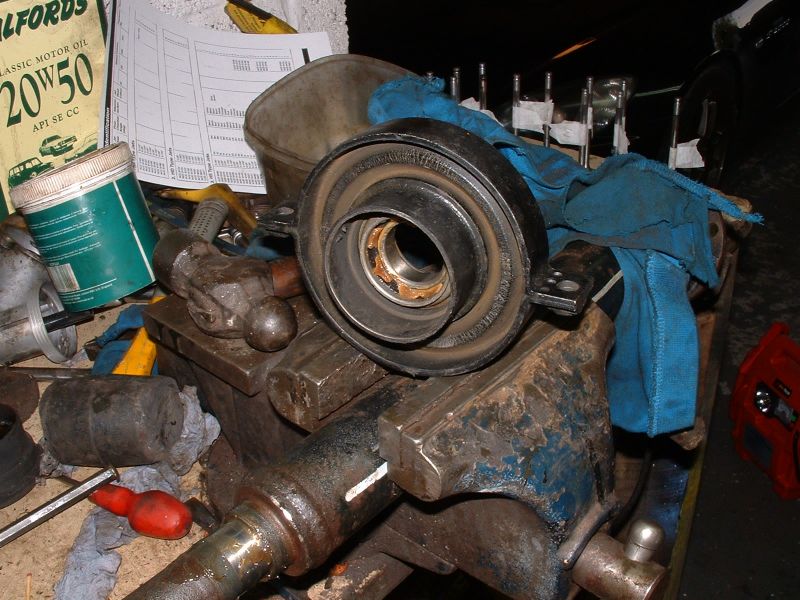

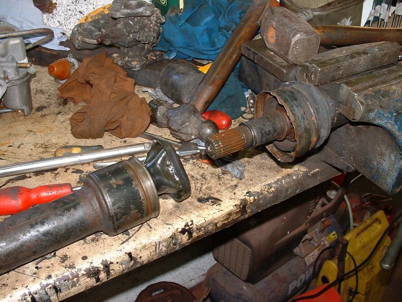

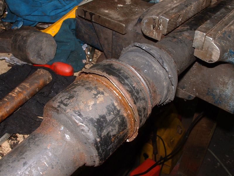

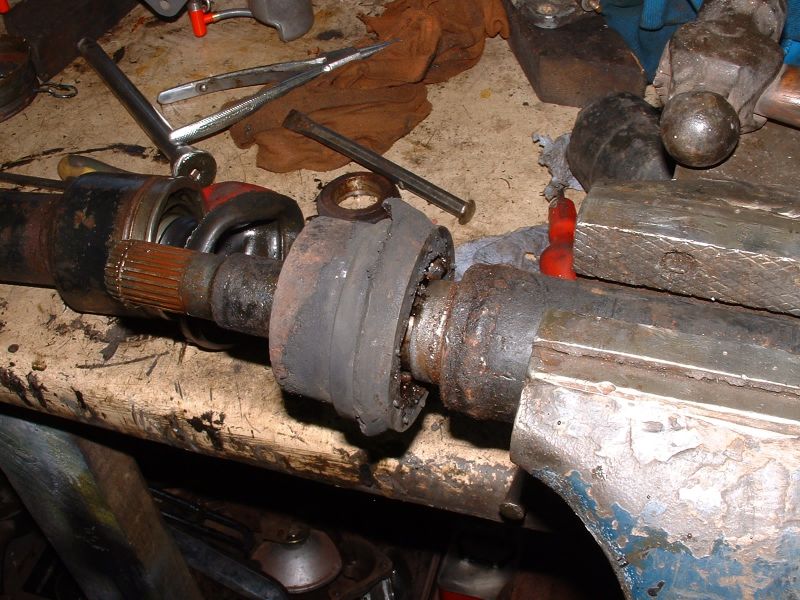

#178 Post by Mad Mart »
I started to split the propshaft yesterday evening so that I could fit the new centre bearing/carrier. One job I've never done before on a Sprint.
Thanks to Tony (Mig Weilder) for supplying the propshaft. :thumbsup:
Woo Hoo I'm a trend-setter! :lol:
Prop looks great!
Thanks for the engine mounting pics, it's sitting much better in the stand now.
