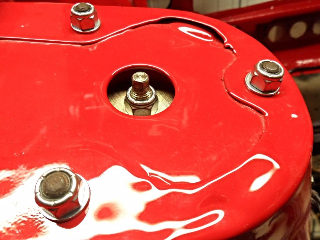

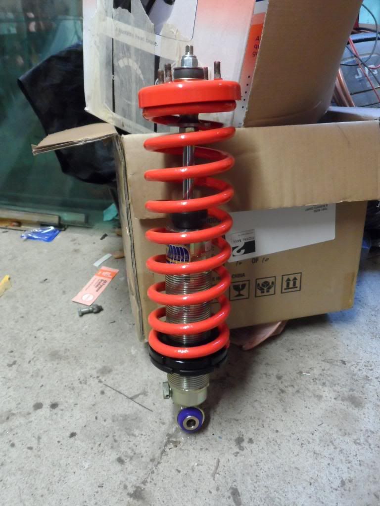

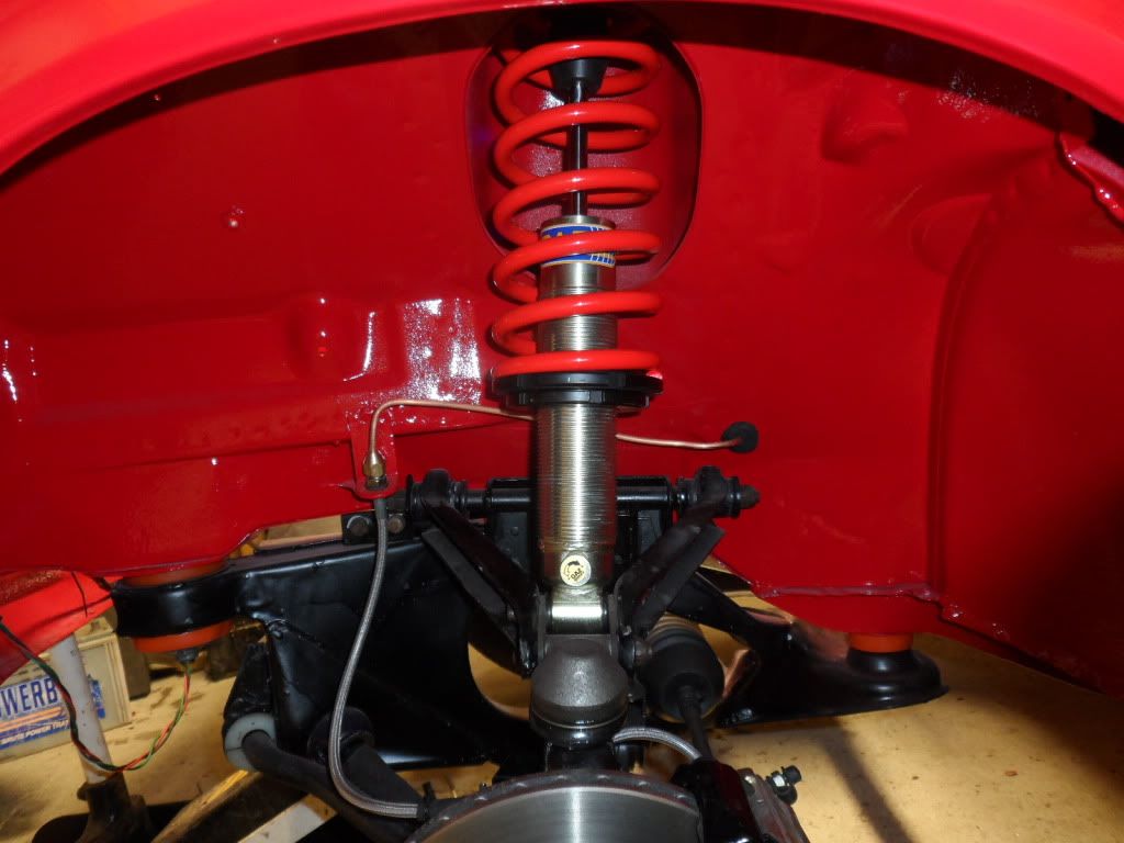

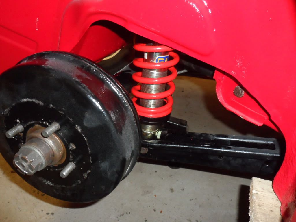

NSF strut fitted......
Finished off with some new nyloc nuts to keep the engine bay looking smart...
Re: MSO 662P
#189 Post by soe8m »
These gaz shocks are really good and i had them for about 100.000km and are still ok. The only thing is that the lower poly bushes are crap. I now use avo front with a lower uniball. The tube where the bush is in was worn because of grinding in the upper balljoints. The last few km i did put a piece of waterhose between the balljoint and lower shockmount so there was no metal contact but maybe you can put something similar inbetween for precaution. And spray some anti corrosion around the adjuster because they can go stuck due to water and stuff or tape the lower part in so that nothing can penetrate in area where the adjuster goes into the shock.
Tony Burd
Posts: 1248
Location: Andover Hants
Re: MSO 662P
#190 Post by Tony Burd »
Thanks for the advice, I did notice that the lower bush on the front struts (black poly) didn't seem as good as the one fitted to the rear strut (purple poly).
I will keep an eye on it although the cars only going to be used at the weekends during the summer, although in Britain being used in the summer doesnt mean dry use only!

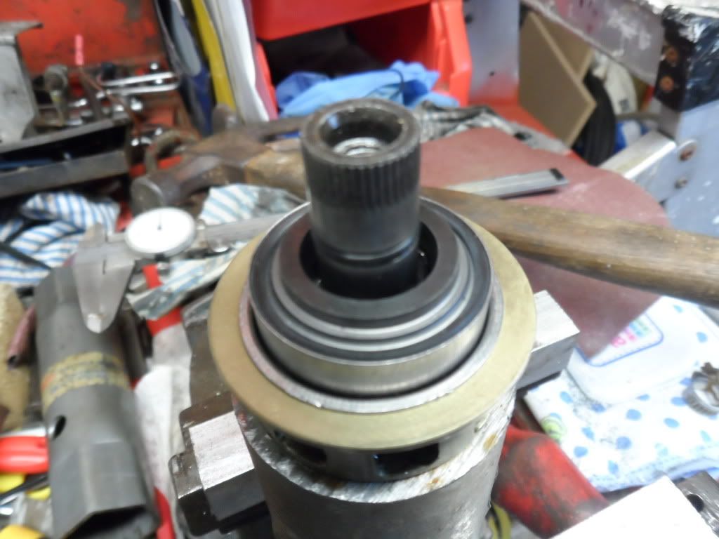

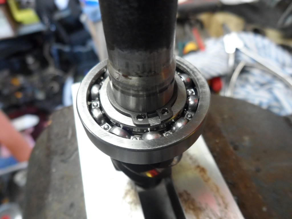

Rebuilt the waterpump over the last couple of mornings in between family get togethers, just got time to post this before yet another family lunch!
I used a rebuild kit from Tony Hart Stag Spares

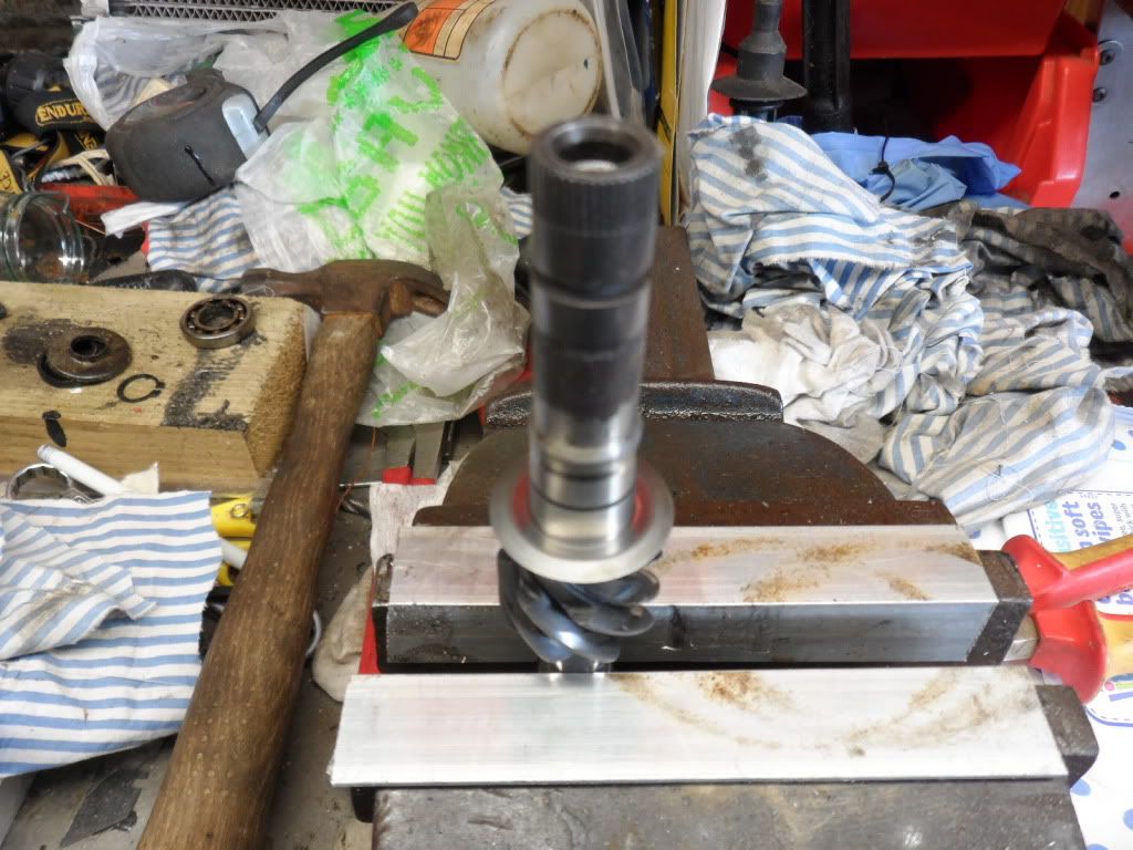

The pump was striped & cleaned, then the new bearing was drifted onto the shaft & circlip fitted:

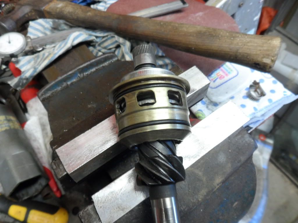

Then the shaft assembly had to be pressed into the brass cage, I found a box spanner cut in half was perfect to hold the cage
I packed the bearing with grease as per the wiki suggestion then fitted the oil seal
Then fitted the water flinger

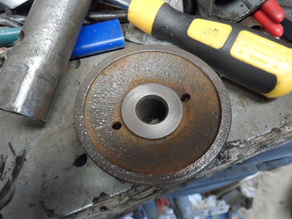

Then pressed in the new top graphite seal & fitted the new O ring
Finally fitted the 2 new O rings to the outside of the cage

Re: MSO 662P
#192 Post by Jon Tilson »
Interesting that you have a new seal but its a graphite one.
Most of the kits I've had recently have an internal seal that doesnt seal on the impeller face.
Job looks good....glad the wiki was of use.
I've never been convinced by the oil seal just push fitting in the brass cage either, but thats how it goes.
Tony Burd
Posts: 1248
Re: MSO 662P
#193 Post by Tony Burd »
Yes Wiki very useful, plus good instructions sent with the kit from Tony Hart, although he says fit the impellor before fitting into the block, which I did on the last pump I rebuilt (before I read the Wiki) & it was fine.
This time I am going with your method as the brass cage was a very tight fit in the block & was difficult to remove, so I guess it is going to be tight going back in.
I was a bit unsure about the oil seal whether it was fully home as you can't be too heavy handed with it as it could be damaged, I had another fully built pump to hand which I used as a reference.

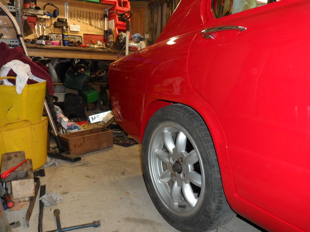

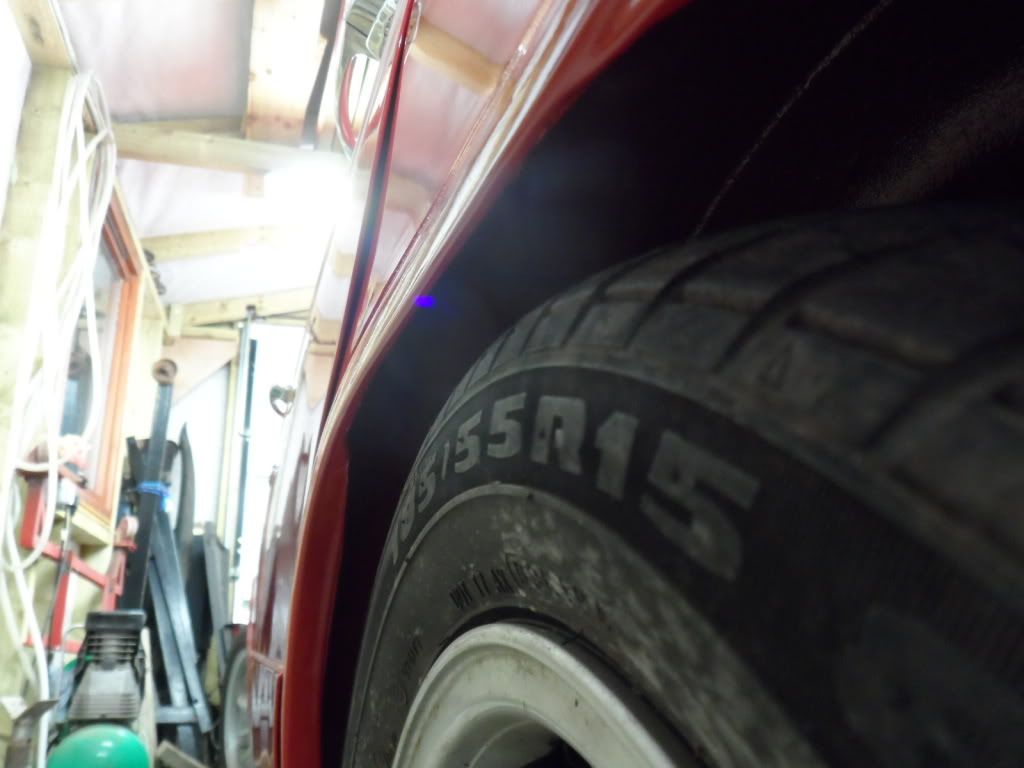

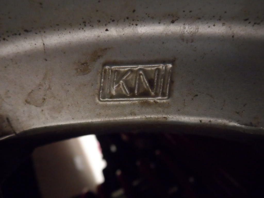

What wheels and sizes are you using? They look to fill the arches well.
Tony Burd
Posts: 1248
Re: MSO 662P

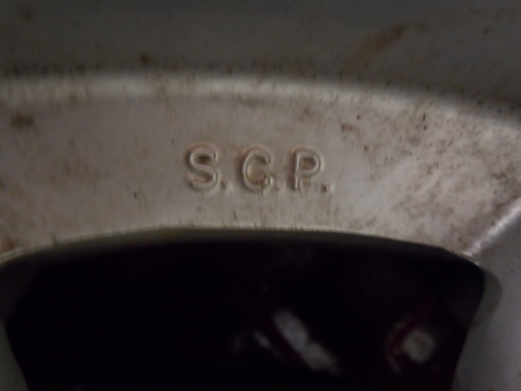

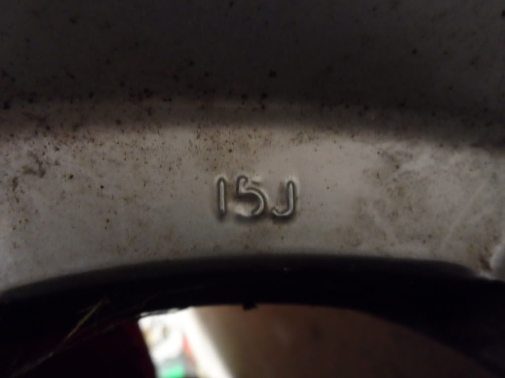

#195 Post by Tony Burd »
Hi Dan,
Can't remember where I got them from as it was about 15 years ago, but I think they are Minator which are Minilite copies. They are 15" & about 7" wide. Here are some pictures of the marks stamped on the rims.
I have had to take to complete lip off the top of the arch, plus I am getting another 3mm taken off the offset to ensure they don't rub.
Just noticed the fit of that door is terrible!
