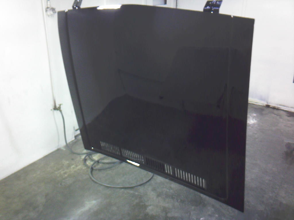

Case of the levitating bonnet.lol

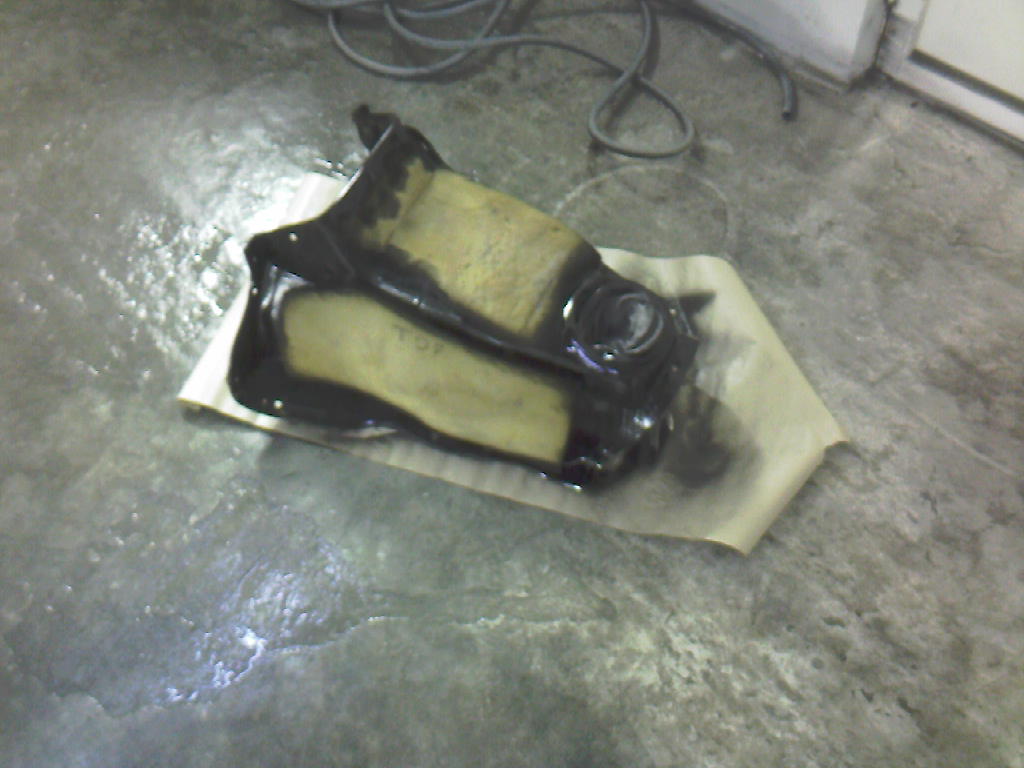

johnnyv1
#199 Post by johnnyv1 »

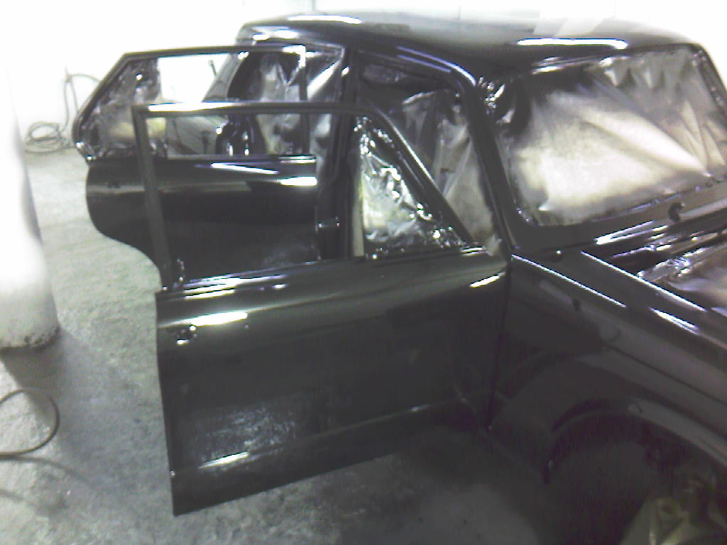

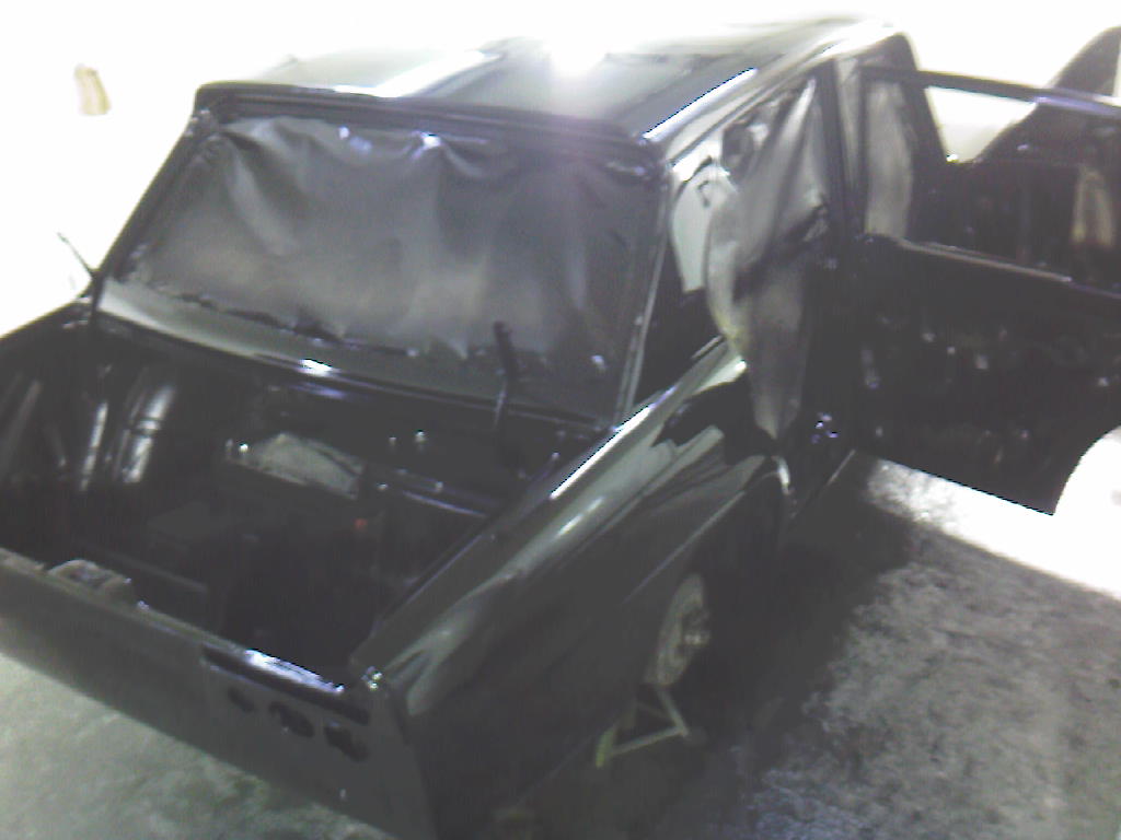

Painted as much as i could at the same time

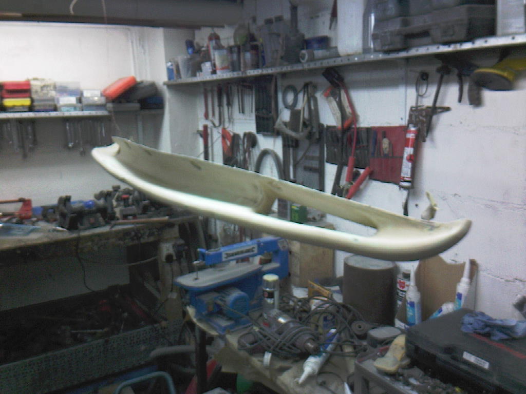

Case of the levitating spoiler

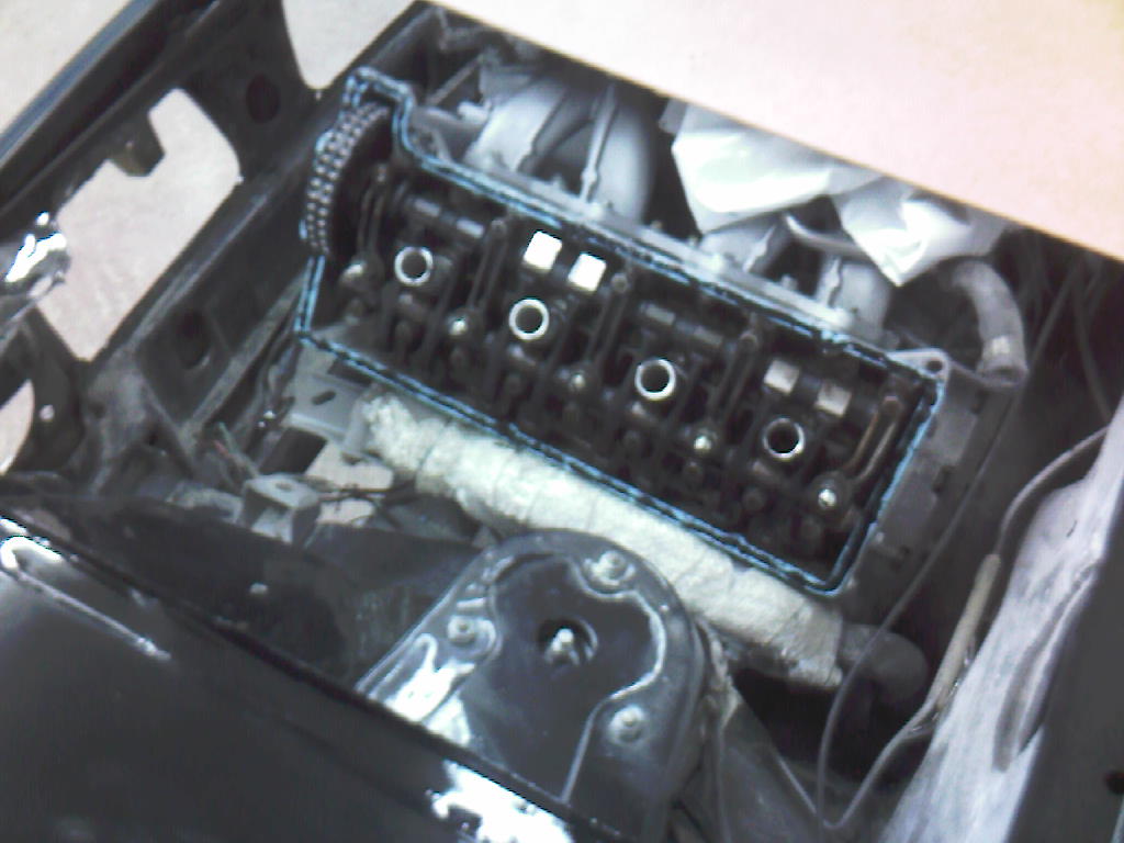

I took the rocker cover off to re paint and fitted new gasket and a dab of gasket silicon around the new aluminium spark plug tube seals to keep the oil out of them,

Ooh, an anti-gravity spray booth, cool. :lol:
Better than Gerry Anderson's puppet efforts, but nevertheless the wires can be seen on the spoiler shot. :oops: :wink:
The black looks amazing on there, is it all to be gloss black, or will a black car still have the satin black finish on its rear end?

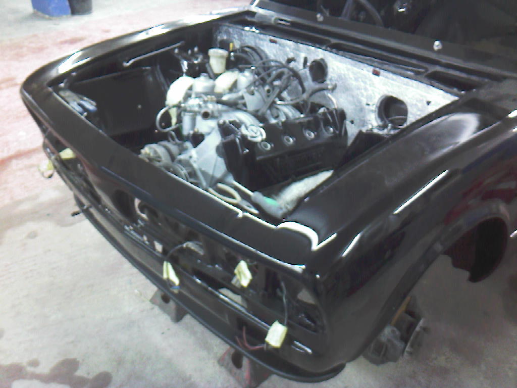

This is how i left it yesterday (sat). I put in a new fusebox and all new connectors to it. I also put new connectors everywhere possible, temp sensor wire had a split which i repaired and shrink wrapped it with a new connector also. Cleaned and polished the starter connections and fitted them up. Fitted the engine stabilizer with new polyurethane bushes.

I wasn't trying to fool anyone, my david blaine impressions aren't that great i know.lol
I may satin black the rear but its not needed right now, i still need to compound/polish the paintwork before all the final touches, and that wont happen for awhile, i will let the paint harden fully over the next few weeks as i put up to 4 coats of paint on most of it! The finish you can see in the pics is my straight out of the gun paint, although these pics are not great i know, its off my phone.I've got more coming soon from my camera maybe next week when i get a chance. :)

I can get away with light scratches as i've not flatted it back and polished it yet, not that i'm being relaxed with it after all this work. Having 4 coats of paint does help too! First two coats of paint were standard 2k, then at the last two i went 50/50 with paint and 2k laquer so i could achieve the extremely shiny paint that my baby dolly currently has.lol
The flatting back/compounding is very important though so i will take my time with that when the time comes, black does tend to show up all the hazy little scratches so you need to use different grades of polish after each other to remove these...
